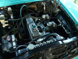

Finally got around to rebuilding and fitting twin su setup i bought from a forum member a couple of years ago. A bit a messing around tunning/syncing them by ear, but worth the effort, as mid range feels heaps stronger, helping the old girl cope when the air-con kicks in.
