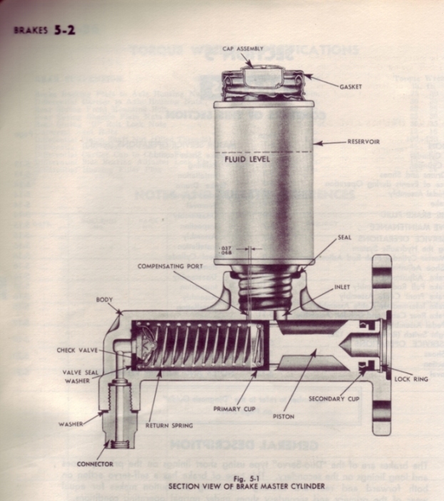

Basically there is no difference between the FE-HR brake & clutch master cylinders. The only internal change is the addition of the residual pressure valve for drum brake master cylinders only. For example, if you dismantled a drum brake master cylinder & threw away this valve & re-assembled it, you could then use it as a clutch m/cyl or a front disc m/cyl.

For those interested I have attached a section view of both the brake and clutch master cylinders with the only internal difference being in the brake master cylinder which has the check valve and the valve seal washer
Matt
Matt
