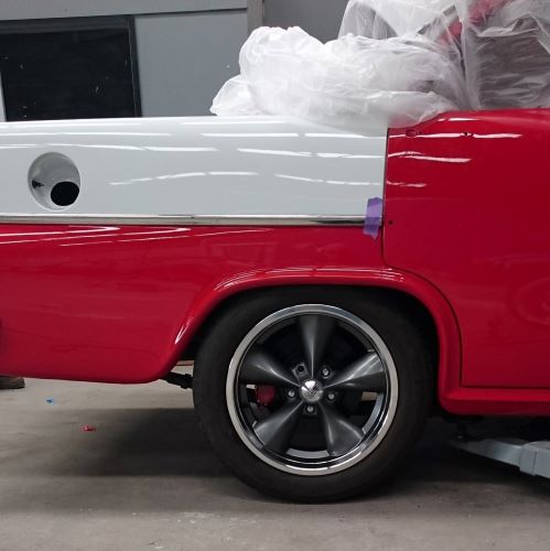

In this photo, is where mine needs to sit, 17x8 with 225/50s, 1" lower scraping issues, not the arch but the inner guard, have about a pencil width to the body. Was meant to be pumped out a little while getting repainted, mother f@#$ didn't do it for some reason, would have gone for 235, only one size but hey, you can never have enough rubber.
You can go 7 or 8" 225 will fit both or 215 & will be able to sit lower. Won't go into off sets cause it has a shortened VN rear end.
Briby
