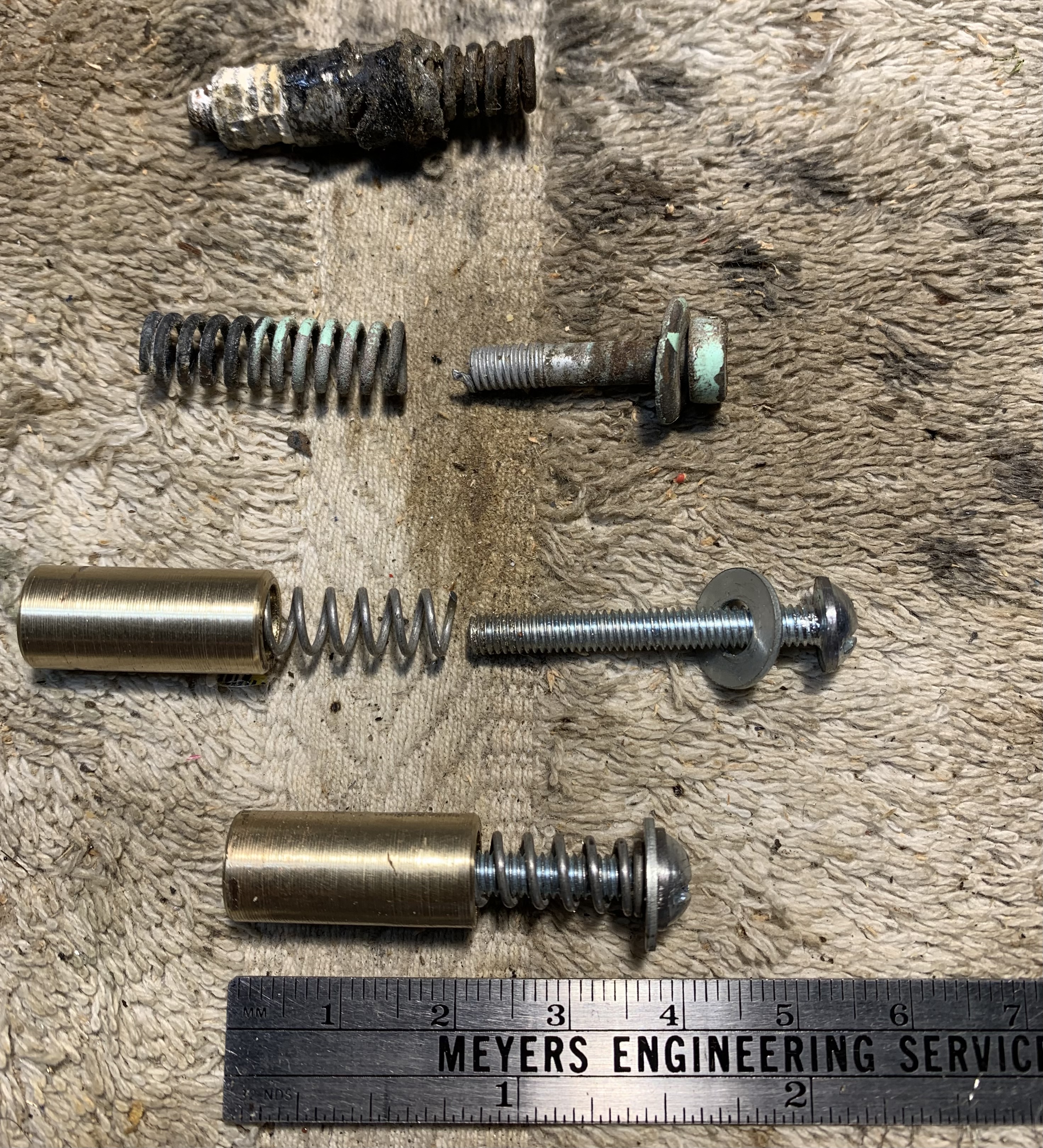

Went to adjust the headlights on the Ute but the adjusting screws were rusted and snapped. Made up a fix by turning up some brass threads to tap out to 5/32” UNF screws. I couldn’t find 3/16” so these should do.
Cleaned up the headlight bucket, then soldered both sides, ran a round file through the hole so the brass was a neat fit. Pushed it through then soldered them into place with silver solder, they won’t go anywhere.

Old parts, with new machined replacement parts.

Cleaned up and soldered in both sides. Can now adjust the headlights (aka high powered candles :shock: ) from spotting possums in the trees to back on the road.

Ingenious mate!

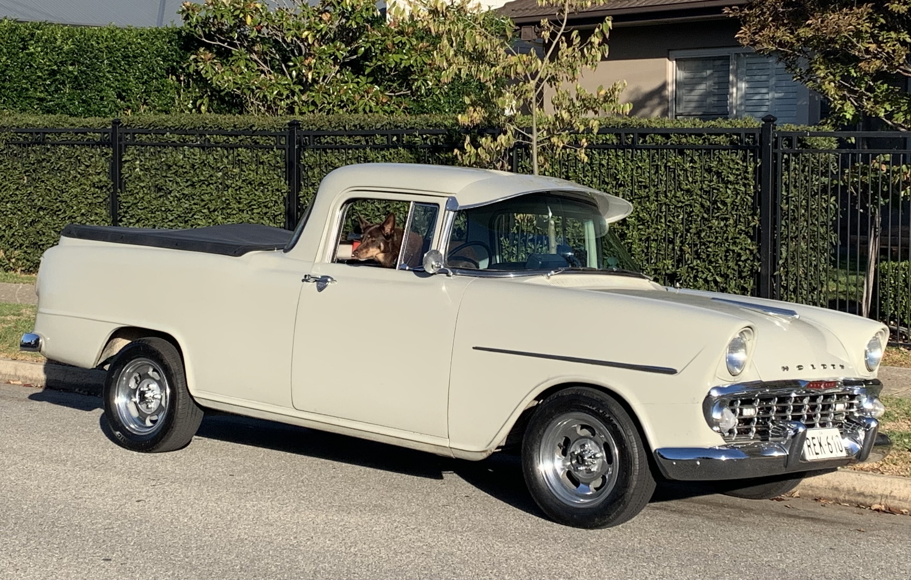

Fitted the 14” jellybean rims to the Ute. Has been a bit of a headache but I reckon it has turned out ok.

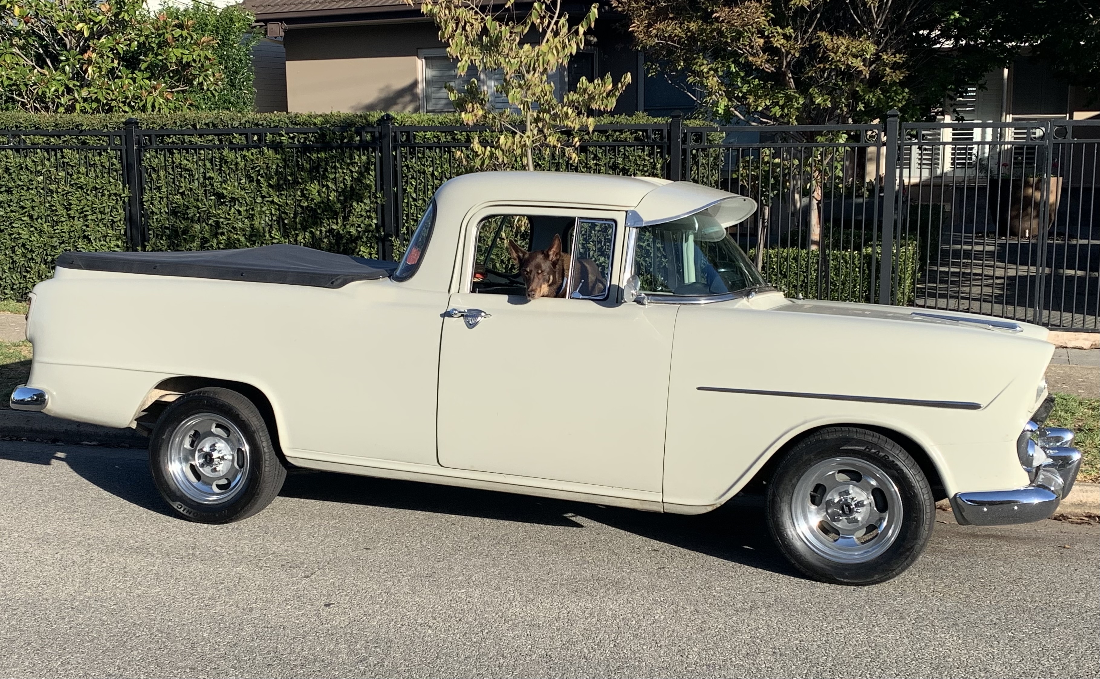

Posts: 2140
And another pic.
