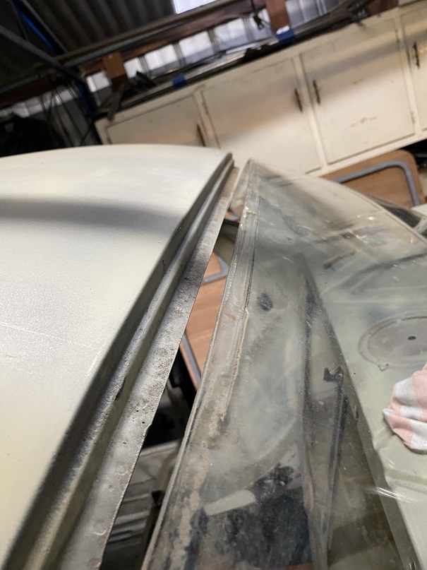

Thinking of doing flush mounted glass for rear window and front screen.
Mocked up the rear this afternoon.
Rear flush 1.JPG (186.07 KiB) Viewed 8511 times
rear flush 2.JPG (187.95 KiB) Viewed 8511 times
Rear flush 3.JPG (151.07 KiB) Viewed 8511 times
Have anyone considered this and if so did you go forward ?

Looks like it would be a lot of work .............
......... but if you chopped it :twisted: :twisted: :twisted: it would fit better :ebiggrin: :ebiggrin:
Posts: 11469
Re: TT Sedan
Yeah just chop it rog 8) 8)
Or are you saving that trick for the wagon?

Agree,
That would be a roof chop indeed, or new glass which would probably not suit as it would be bigger looking.

New glass is $$$$$$$$$$$$$$ , I have looked into it and its the primary reason the 2 door isnt getting chopped .....

I mocked up the front windscreen but not liking what I see.
A large gap at the top would need to be filled so it is on the backburner for now.

Wrongway Roger wrote: Sun Aug 27, 2023 6:56 pm I mocked up the front windscreen but not liking what I see.
Pushed the sedan out of the shed and wrapped it up as Ammo's ute is back.
like everybody else said chop the roof

A minor chop of 40 mm, I could get away with standard front and rear.
Side window glass no issue as flat but the rear triangular glass would be custom.
I have custom cut glass in Ammo's ute as I took out the vents but that took a couple of goes to get it right.
The chop would involve a lot of panel work and would hardly be noticable.
I have time to consider what I will do while I assemble Ammo's ute.
some say they are the best chops, not in your face and has people scratching their heads wondering what have they done :wink: 8)
