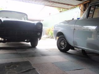

Hey Guys due to the EK needing alot of work and little funds i have put that on the back burner and have purchased this from some fellow members :wink:
She almost got sold but a change of heart decided against it. :twisted:

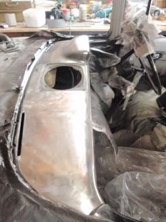

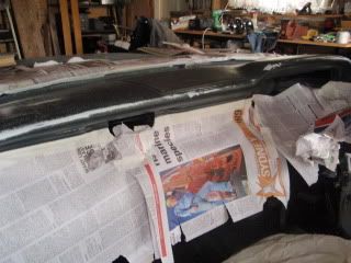

first up was the dash coz it was knackered.
end up doin it twice coz wasnt happy with it the first time.

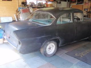

then did the outside of the car in acrylic matt black after a sand with wet n dry 400 hundred then 600.

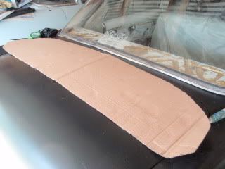

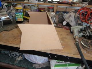

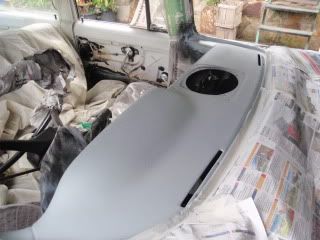

next was the parcel shelf
made a template out of cardboard for the shape then went to bunnings and got some 6 mm mdf
mind u i end up redoing this in 3 mm as the 6 mm was too thick.

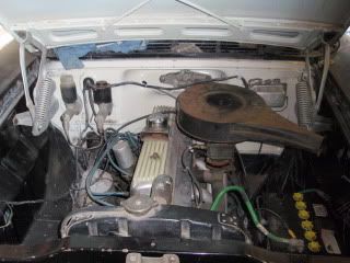

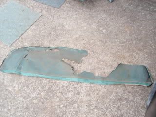

oh and this was what was left of the old one :roll:

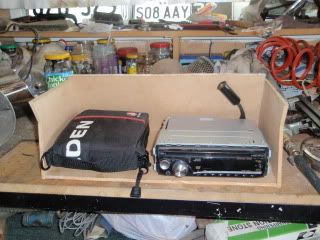

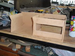

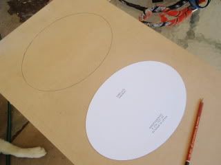

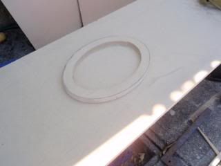

cut out the spacers for the rear speakers in 16mm MDF.

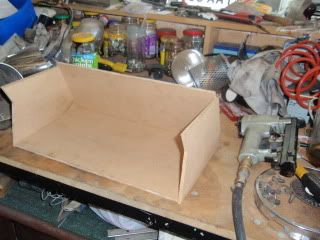

then got stuck into the custom glove box.. used a couple of the ideas had seen on here thru few other guys but made a template from the original glove box and made up a space for the cd player to go nicely. 8)
I kept the old glove box as well as the cardboard templates which i made up incase need to make one again down the track
S.A- The No drag strip state
classic_62
Posts: 195
Joined: Tue Jul 18, 2006 8:36 pm
Location: Radelaide S.A
Post by classic_62 »

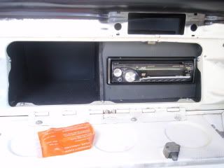

made sure would have nuff room for the both n trial fitted it first, then continued on with the rest. Used liquid nails and air gun to stick together
then gave it a lick of black paint and made sure the cd fit in.. :lol:
also made sure the speakers actually fit in too!
have now wired speakers and cd up just gotta run accesories, check to make sure it works real good then make door trims up
