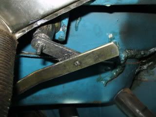

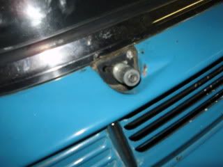

Hi all,
My drivers side wiper is playing up, only wipes about a 25% area of the middle section of the windscreen. Im thinking the spindal thing that attaches to the wiper arms need replacing.
But how do I get it out to replace?
I have removed the wiper blade, retaining nut and crome spacer from the outside and now working under the dash.
The book I have has no picutres but says under the instrument panel to remove the retaining clip. I cant see any retaining clip, only a small screw which I dont think I need to undo.
See pics.......
Behind instrument panel......
Can anyone tell me how to seperate the wiper arm from this spindal thing or how to approach the problem.
Thanks,
It's allot easier to remove the whole arm from the motor end of the arm and replace the whole arm, Trev 8) .

Thanks Trev,
Ive never done this job before and am relatively new to fixing cars - (I only tend to fix stuff that breaks) so Im going in with L plates on. :(
Heres what I think I should do:
Step 1. Disconnect the arm at the wiper motor
Step 2. Remove arm. Does the spindal thing simply pull through from behind the instrument panel or is there some other steps?
Step 3. Buy a replacement arm. (Im guessing these are stocked at decent auto spares shops)
Step 4 - put back together. :idea:
Hows this?
Sounds good except for the getting a new one from a spares shop, aahhh no :roll: , Step 3 should read ; ask on here if someone has a spare they want to sell me :wink: .
We all started somewhere Mick, just remember, it goes back together the way you pulled it appart :wink: :idea: , Trev 8) .
