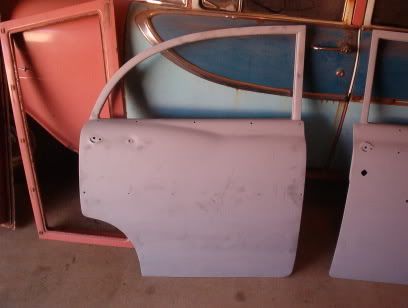

Here's a few pic's of my FB getting a new lease on life. So far all doors and tailgate have been sand blasted to show various levels of rusty holes, they have been metal filled and led wiped (trying to use as little bog as posible). Then sprayed in 2pac etch primer waiting on the rest of the car to catch up. Started to strip the shell to find some old rust repairs using fiberglass in the floor, this will have to be replaced along with the tunnel for an auto one. A trimatic will be slotted in behind the grey motor. Any sugestions or advice will be gladly taken. Trev.

As far as putting a Trimatic behind the grey! DO IT! You will be pleasantly suprised (as I was) at the difference it makeswhen you are getting closer let me know and I can help you out (having done it before) and put you in touch with the right people to get the gear off.
