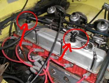

i replaced the rocker cover on the 202 with a chrome one...
the top hoses, need these little grommet things in order to fit into the cover... i can't pull the old ones out...
does anyone know what they are called so i can buy some new ones?

just breather hose gromits, are the hoses connected. if not there are single hole rocker cover of older reds. have not seen many triple setups so don t have much of an idea of how they run cover hoses. love your car photos you do, wish my car was worthy :(

thats a pic of the engine i bought still in the car....
so im not sure what the hoses hooked up too...
someone was saying i can just put oil breathers in there...... but i dont know :?: :oops:
does anyone know where those hoses connect to??

front one should go to a fitting on the manifold that is to release crank case preasure and it just goes into the motor and burns cant quite remember the back one, of the top of my head, one of these other guys will probably tell you faster than i can look it up in a book. 8)

the back one actually looks like the PCV, but the front one usually just goes to some type of breather, eg. air filter on a carby etc .... you can actually block it off an use a air filter oil cap if you would prefer ....
this is a pretty shit pic, but you can see at the rear is the pcv that goes into the base of the holley or into a fitting in your manifold, then the front hole is blanked on my tappet cover and the oil filler hole just has a filter cap on it.
