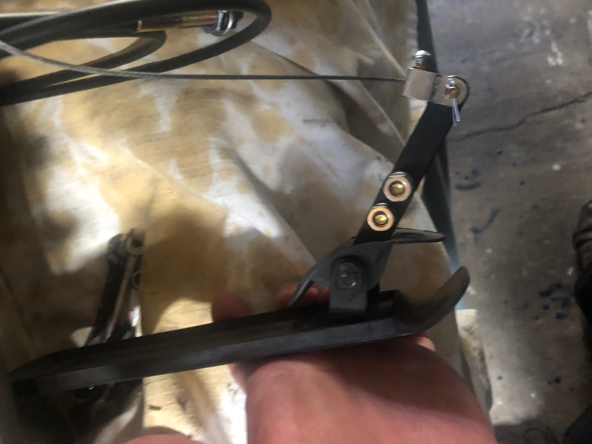

Another option for the cable (for those who can't weld): original pedal (this one is a Rares replacement), short extension on the pedal arm, and aftermarket cable kit from Flexibledrive.

Check how much cable pull you need once you have the carb manifold linkage put together.
The standard pedal will give you 12mm of pull. Extending it 40mm will give you 35mm of cable pull.
Extend it much further than that and you can hit the y-frame leg. If you need more cable pull, change the lever length up on the carb manifold linkage (shorter lever = less pull but more force needed).
