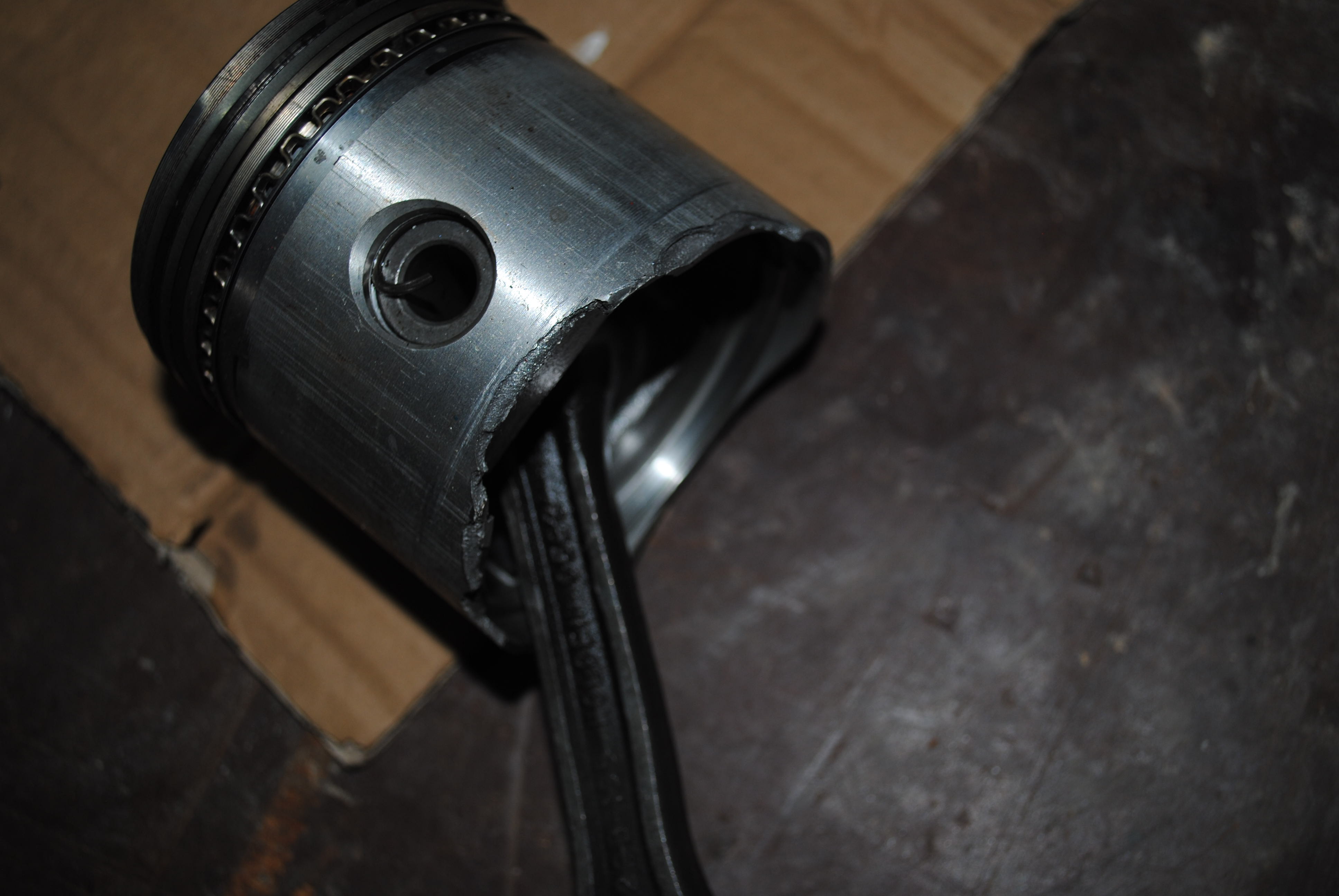

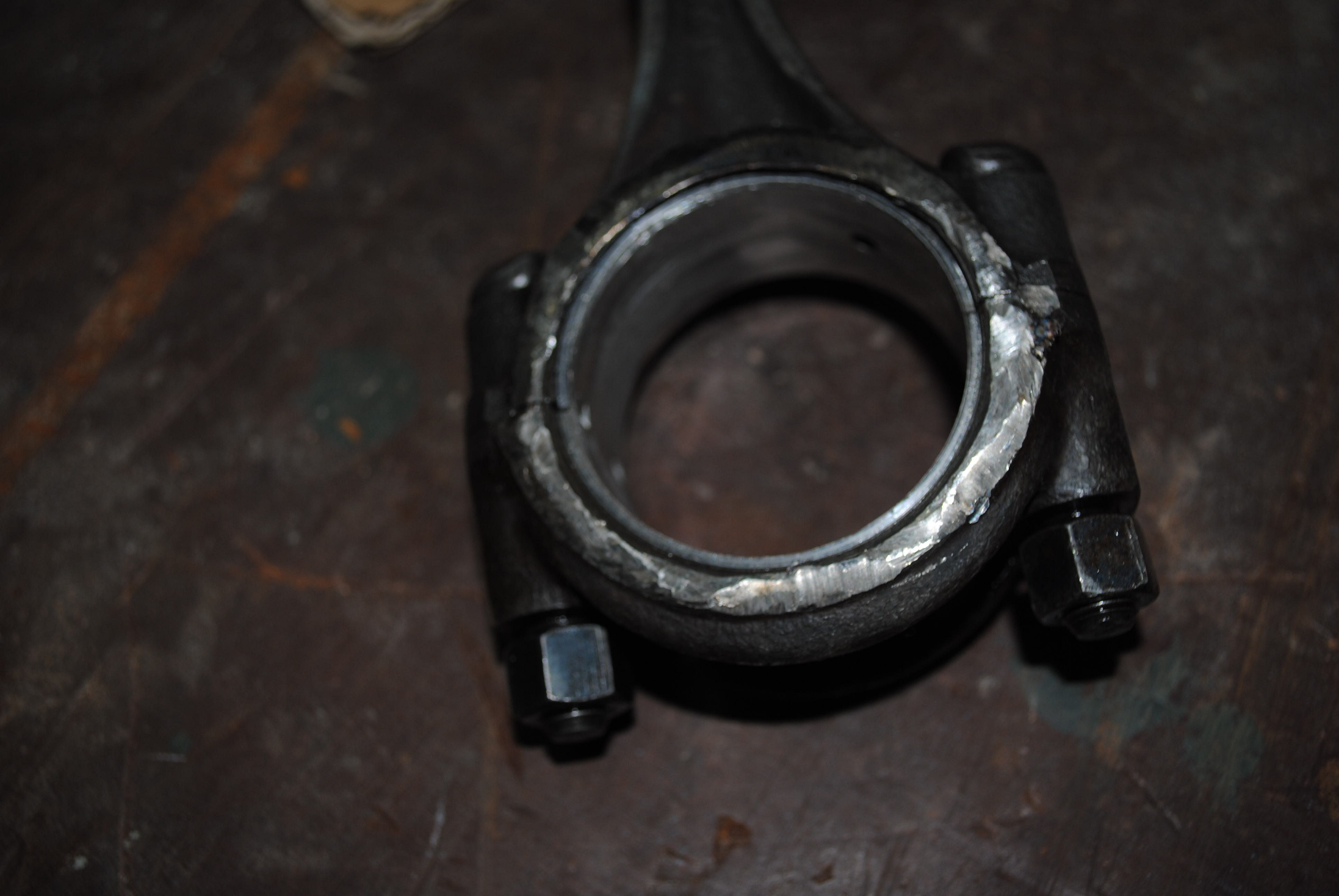

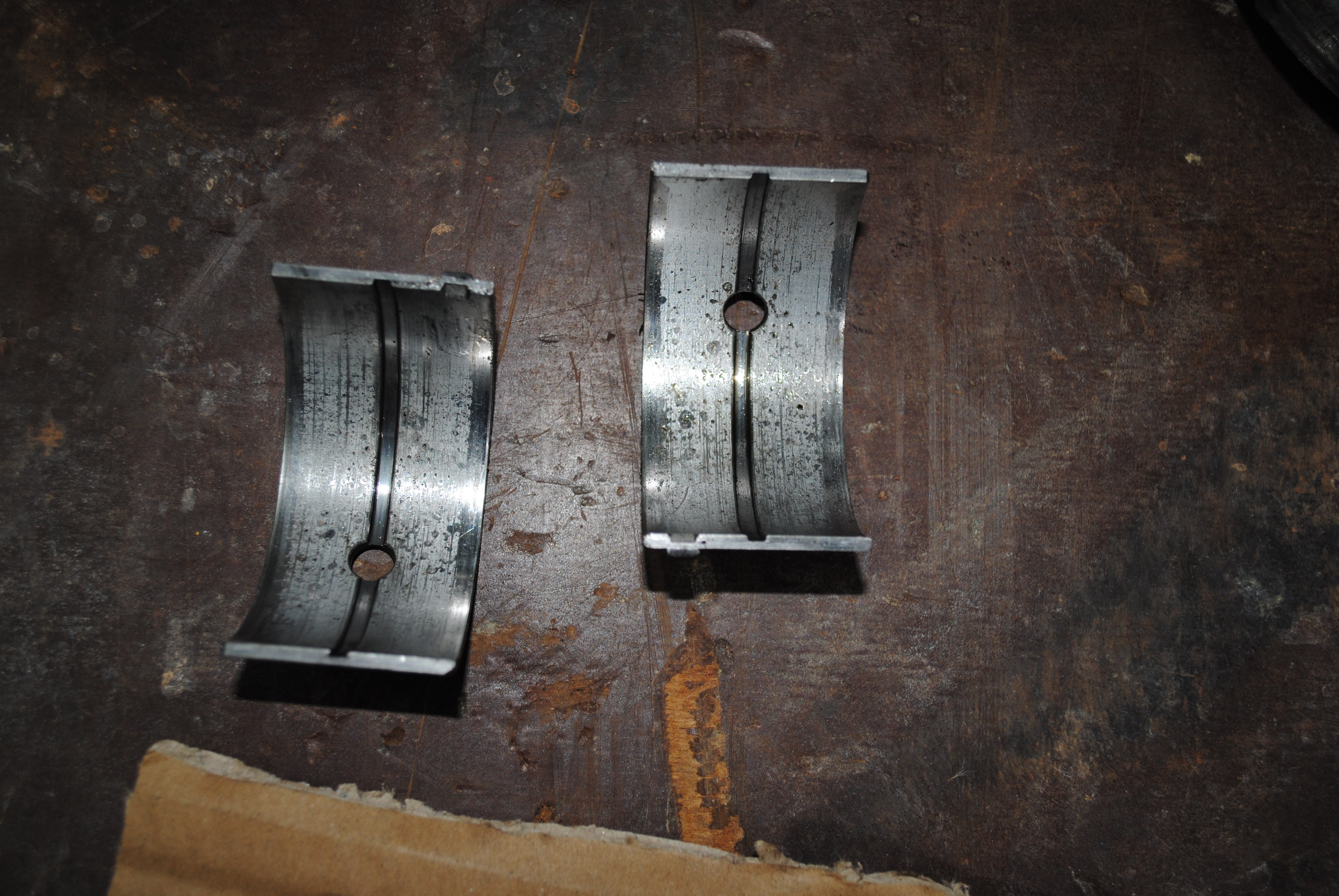

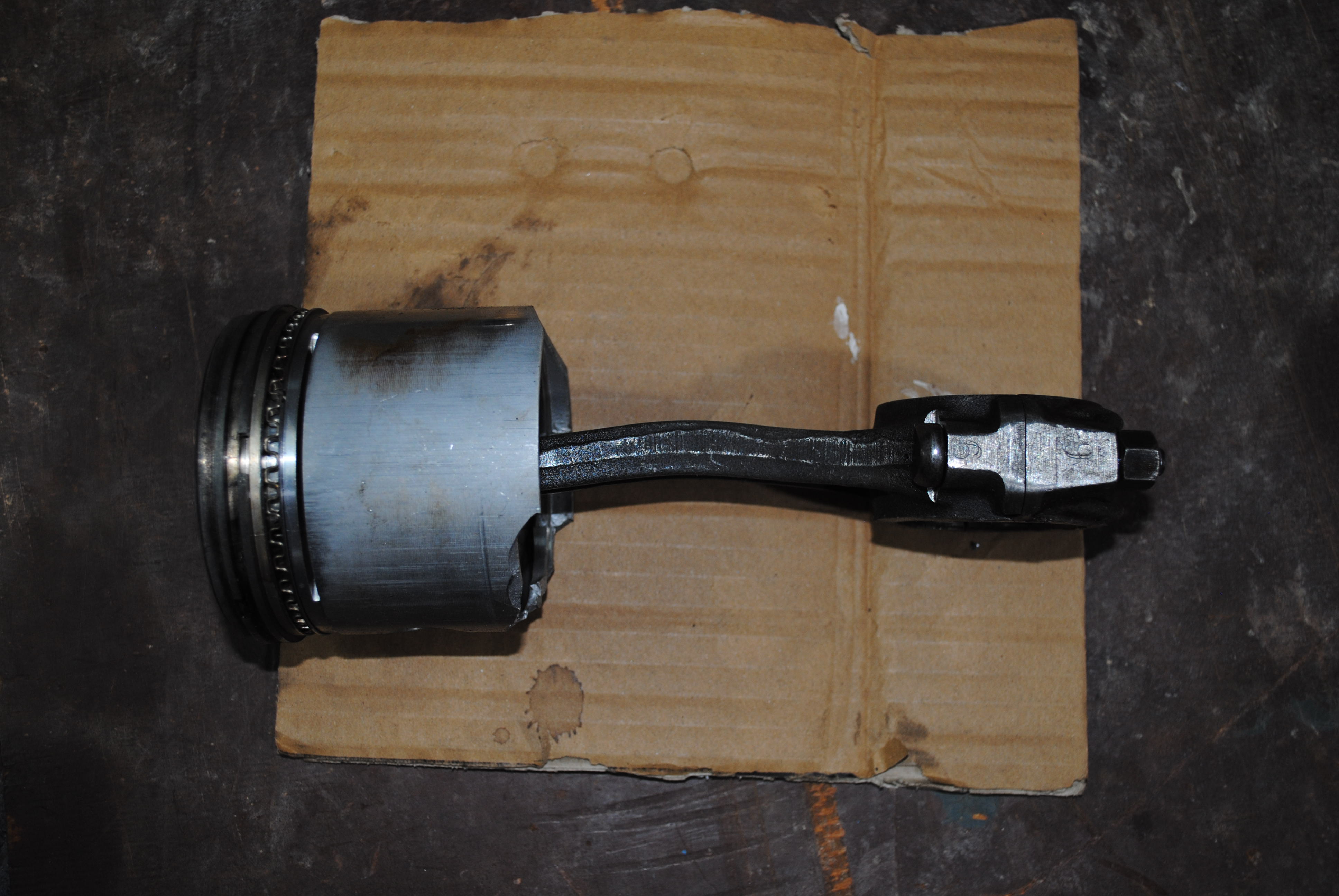

Just an update on the engine that expired at the Six Banger nats. Not only did I break the crank but bent no.6 conrod and busted the bottom off the forged piston. Bearings are shot as well. I have one race left this year at Gunnedah 1st November and hopefully the spare engine will stay together for the weekend. We race both days so it needs to survive for about 14 runs.

Bugger :crazy: any pics ? Was it just a fatigue failure or did you zing it or run out of oil pressure or something ??

spanners wrote: Mon Oct 20, 2025 8:50 am Not only did I break the crank but bent no.6 conrod and busted the bottom off the forged piston. Bearings are shot as well.
Ouch. :(
I've got some spare rods if you need one. I guess SPS will make up just a single forged slug. Did it do any damage to the bore?

Thanks Harv. I don't think the bore got damaged but I'm planning on getting another block bored and starting fresh. I've got some spare EJ rods and I'm going to see if Kevin Pryce in Cardiff, NSW can source another full set of forged pistons from the U.S.A. He got the last set for me and they were cheaper and better quality than the cast ones from J.P..
I haven't got any photos yet but as soon as I do I'll post them.

Photos worked out good,
When an engine lets go it does extreme damage, usually scrap metal for most.
I still remember when my trusty 186 let go, crank broke, 2 pistons out the side of the sump and block, counter weights hit the camshaft and sent it out the side which took out the alternator. Head scored and valves all bent. The only thing that survived was the starter motor and water pump, no more reds after that !!!!!

Looks like you have nailed the photo posting bit ........
that rod does look a bit wonky :crazy:
