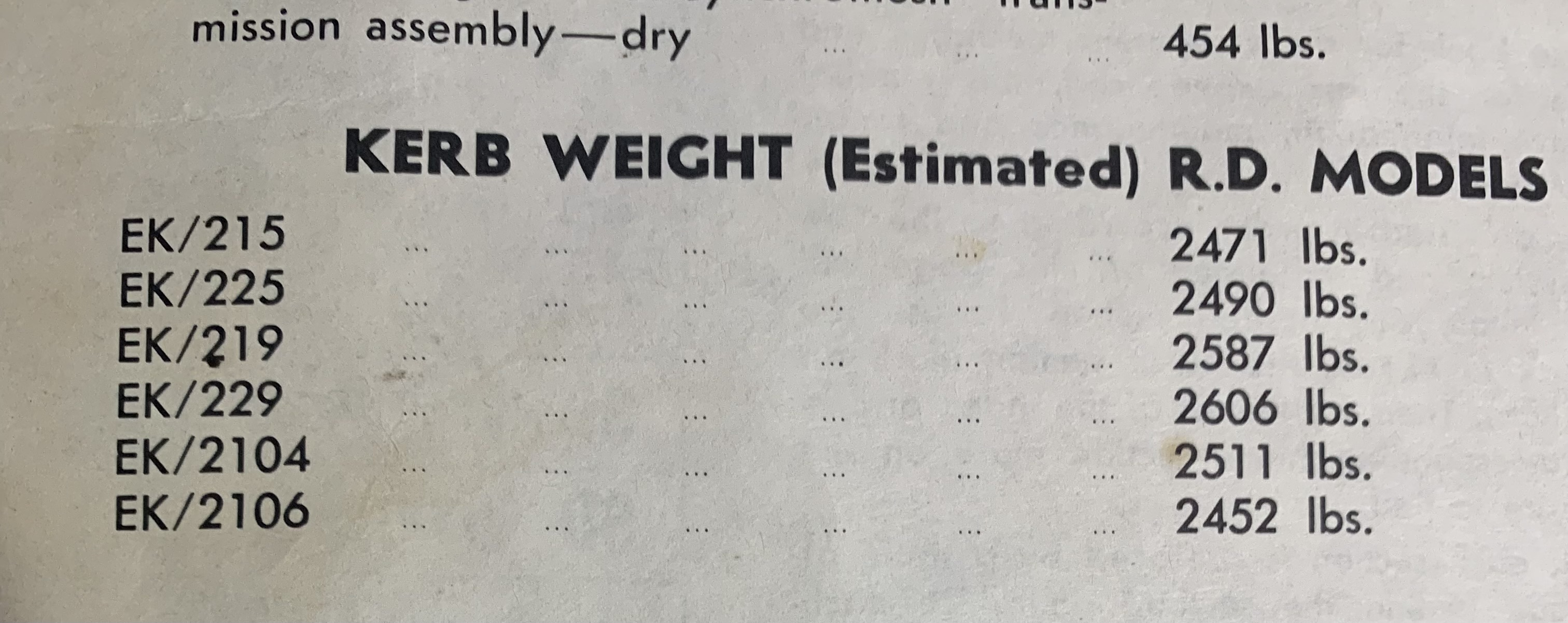

Here you go Harv, on my EK Ute

Re: FB/EK commercial maximum gross weight
Posted: Sat Aug 30, 2025 1:04 pm
by In the Shed
So it would seem the car weighs around 2452 lbs according to manual (1112 kgs).
Total gross load is 50kgs x 30 = 1500kgs
That leaves 388kgs for driver, passenger, (my kelpie), fuel, spares, tools and load. Seems pretty minimal by today’s standards or have I got that wrong?
Posted: Sat Aug 30, 2025 3:52 pm
Thanks mate.
EK ute GVM = 32cwt = 1625.7kg
EK ute kerb mass = 2452lb = 1112.2kg
EK ute payload = (1625.7-1112.2) = 513.5kg
FB ute GVM = 30cwt = 1524.1kg
FB ute kerb mass = 2470lb = 1120.4kg
FB ute payload = (1524.1-1120.4) = 403.7kg
Note that those payloads are on top of a full tank of fuel. Less fuel, more payload.
