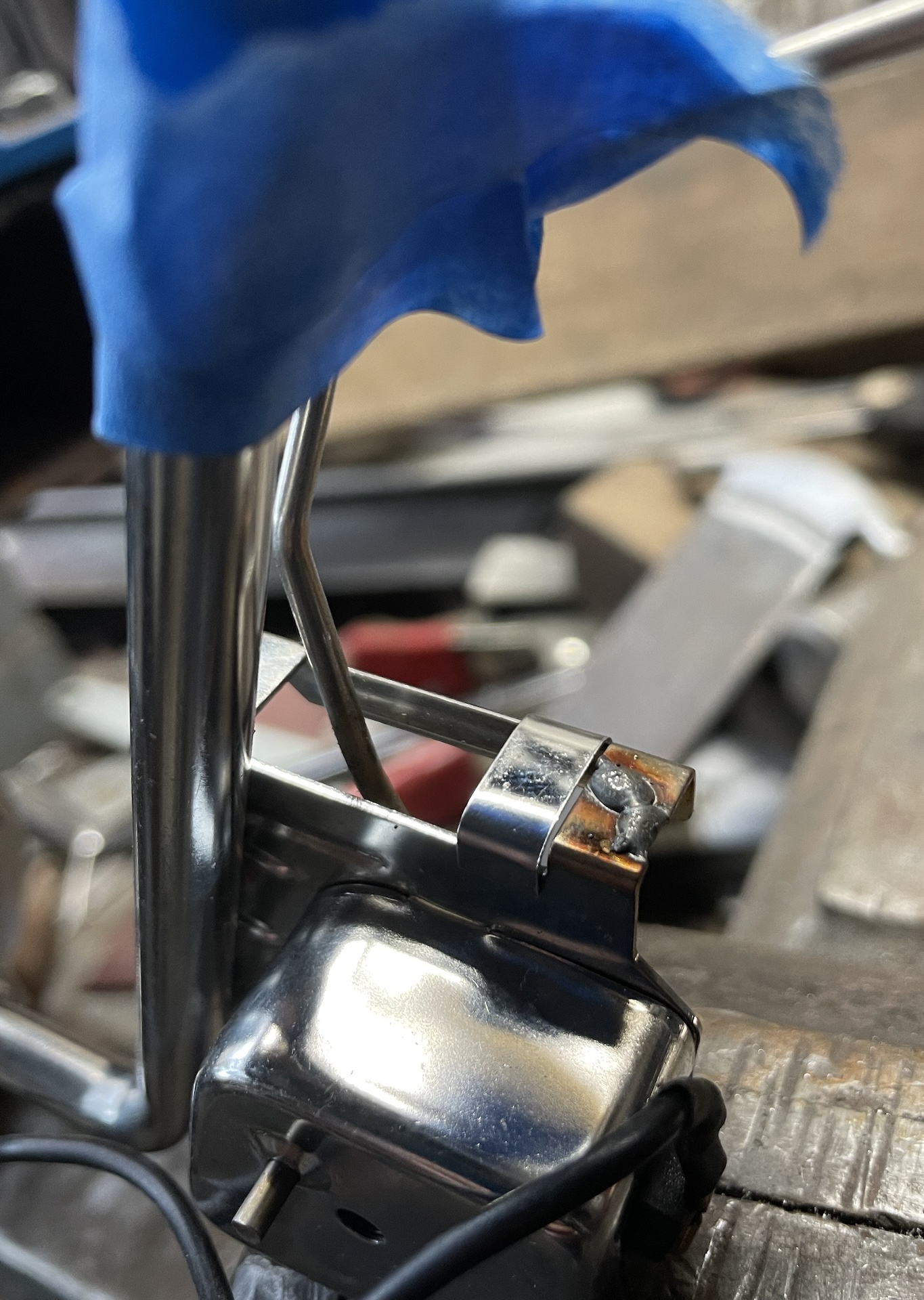

Following up - I got some stainless wire for the mig and tacked an end stop on (photo is pre weld) after re bending the arm to allow for a little more space between the float and the bottom of the tank. Now the float sits just below the top and reads 47 Ohms so I will have to re do the parallel resistor to suit.
Scott

ardiesse
Posts: 1172
Re: Mustang Fuel tank Sender Problems
Post by ardiesse »
Scotty,
Using a resistor in parallel will affect the linearity of the resistance/fuel level relation.
So here's a crazy suggestion:
You've already performed surgery on the sender unit. It won't be that hard, now that you've mastered the internals, to rewind the resistor to 30 ohms, using the existing resistance wire.
Posts: 13746
Do you have the room to extend the float arm to limit travel so it only goes from zero to thirty ?
