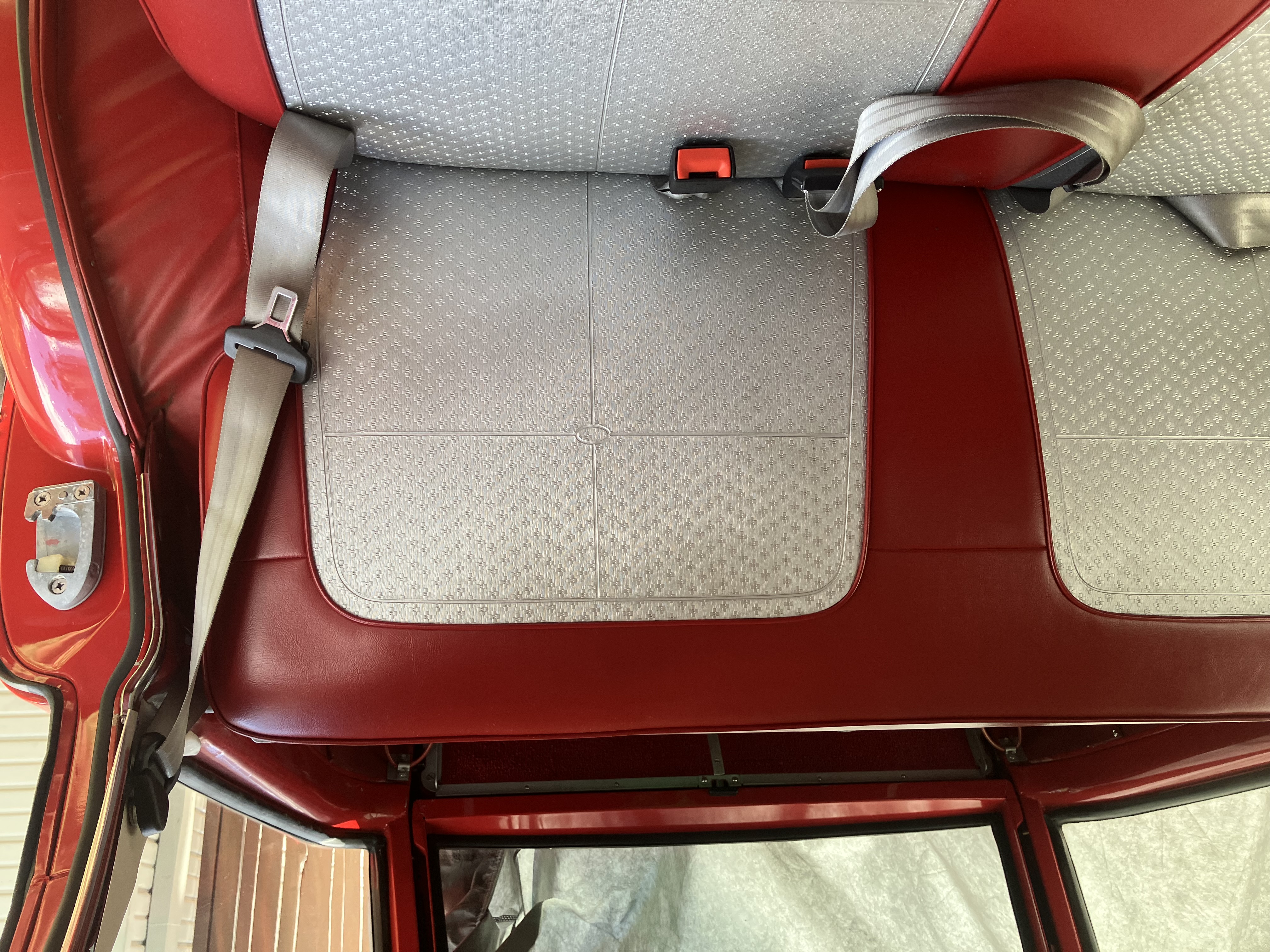

Calling all you wagon owners (Hope you are listening Harv)
Can any of you give me an idea of how you put your retractable seat belts into the back of the wagon, possible some measurements too :ebiggrin: :ebiggrin:

I demonstrated these belts, to a rather particular engineer, to be NCOP compliant. The only thing he did not like was drilling and UNF tapping the C-pillar plates. The 10mm plate is not as thick as a UNF nut. Had to retrofit a nut back in there with fishing line, wire and swearing. Other plates are the standard cad-plated ones from HEMCO, BFH’d to the floor pan contours. I have all this written up into a seatbelt guide, but have yet to finish it. PM me an email address if you want a copy of the draft.

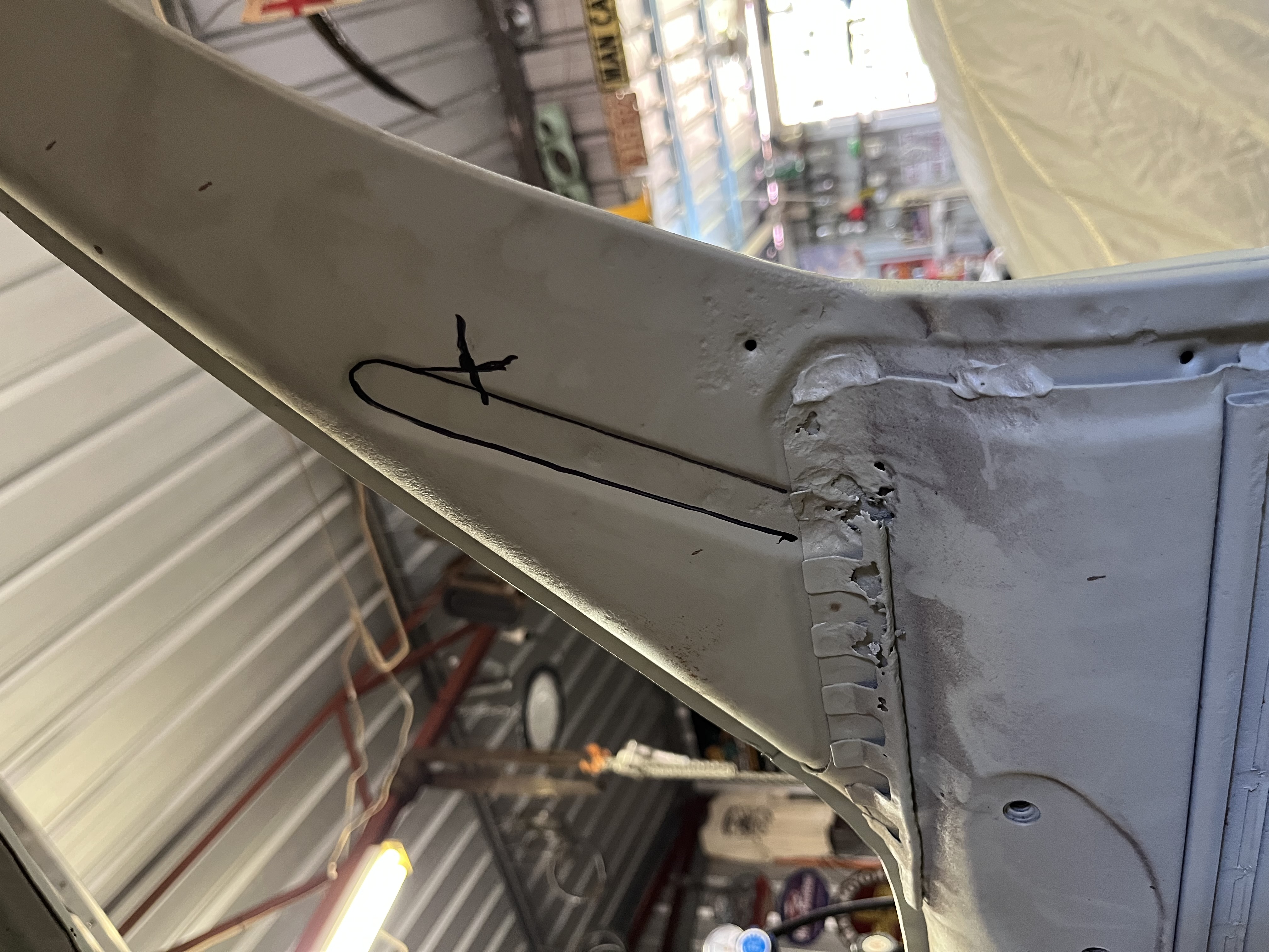

Harv sorry to bug you, I’ve been fitting my seatbelt doubler plates, your guide has been a great help.
Got an issue with the C pillar plate, can you tell me what you did, there is a formed section in the pillar (see photo) and I have marked where the bolt should go, trying to get my head around how I can fit the plate.

Posted: Thu Jan 02, 2025 3:16 pm
When Dave did the bodywork, he made some plates. They are the ones traced out on the notebook paper in the photo above. I thought he cut open the c-pillar, put the plate in then stitched it back up. The bottom of the c-pillar is open though - may be able to slip them up from under. When the engineer did not like the tapped UNF holes, I lowered fishing line in from above, pulled up a UNF nut-on-a-plate, pop-riveted it in then removed the fishing line.
