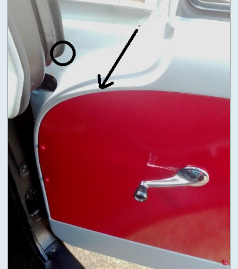

I'd dry it off and give it another squirt to trace where it's getting in ... pic from my thread ... my new seals needed to be 'trained' on this corner .. water got through (and followed the arrow)

Got more info , it’s leaking past the glass and into the door - as they do.
Problem isn’t really a problem 👍😎😎

From memory (damn it), one of the outer rubbers I looked at blocked the drain holes in the bottom of the doors (when closed) .. whereas another kit had notches to let the water pass through
