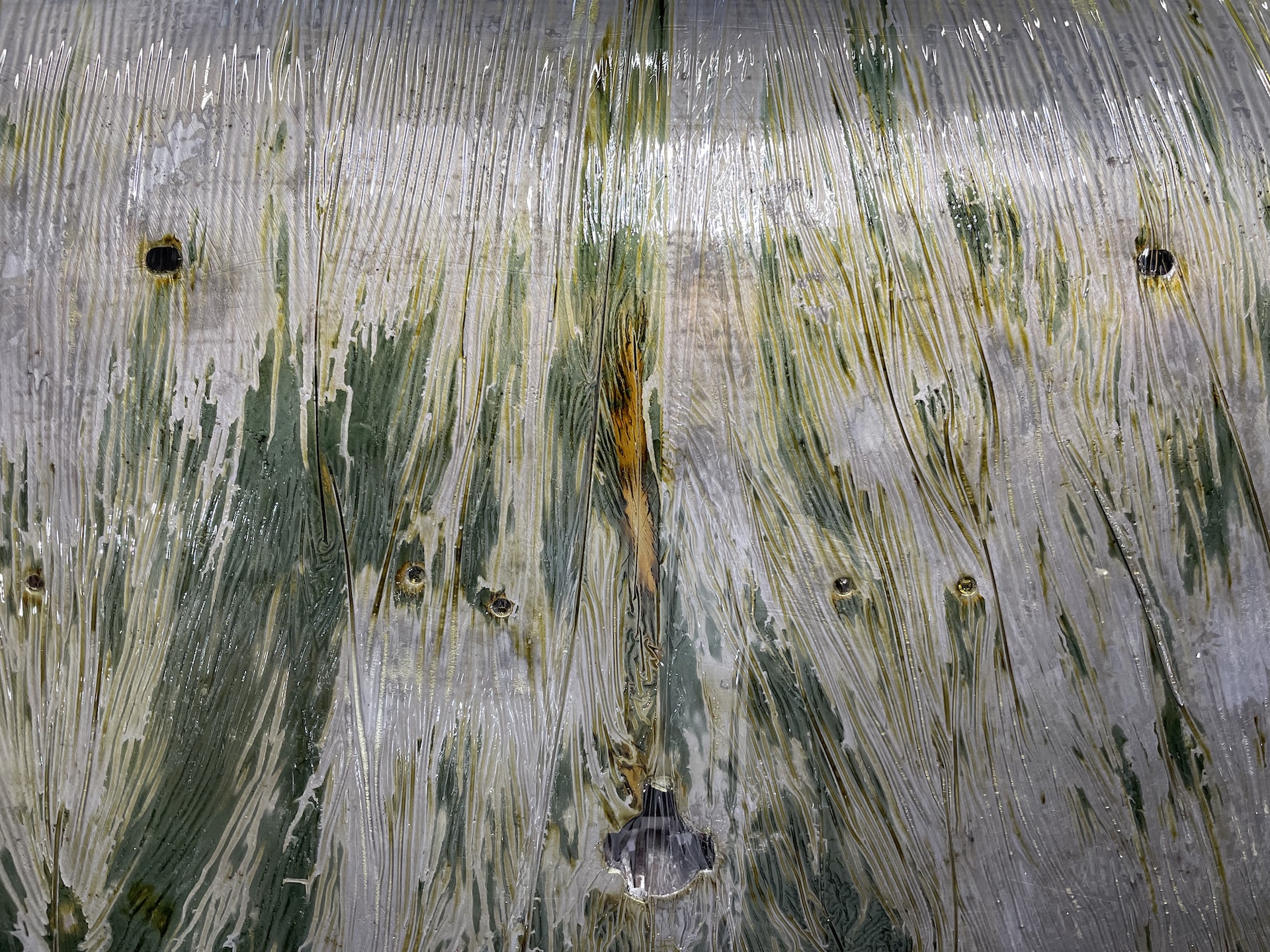

Applied to test area of the boot lid. It is thick and needs some sort of applicator (spoon).
Wire wheeled the test area first, then applied paste and covered in glad wrap. Used a small roller to help distribute the paste under the plastic.
Left overnight, scraped off paste, saved in a jar, and wiped surface down with water several times to neutralise.
Once over everything again with the wire wheel

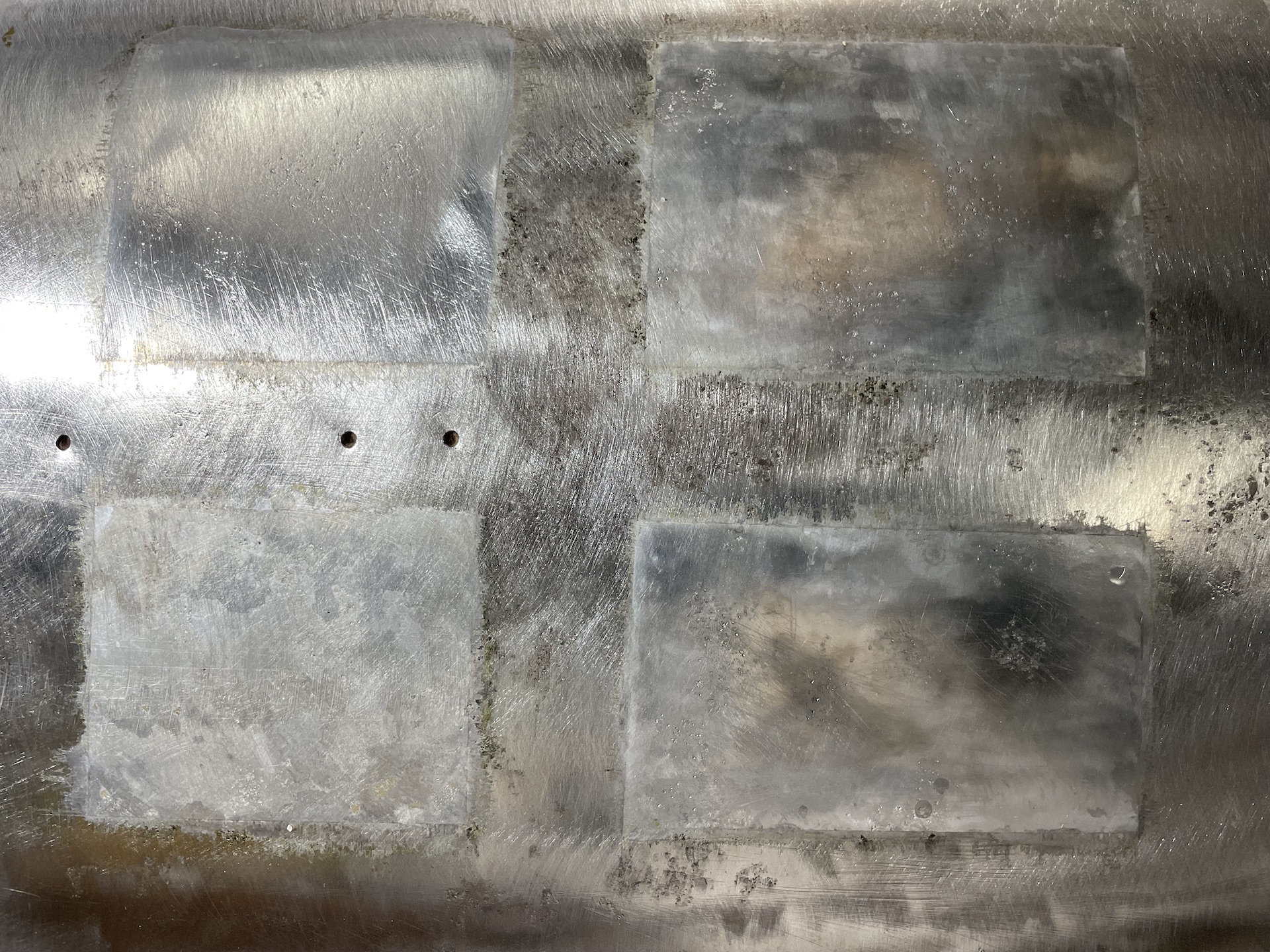

You can see the untreated areas, that was covered by the masking tape, contains a lot more surface rust than the acid treated sections.
Had to go over all the other areas I missed with the paste which I managed to save enough of to re use.

Now onto the gel. Applied with a 30mm brush to the whole panel and covered with glad wrap. Three hours later The next morning. Gel has gone quite liquid under the plastic. Wiped down with water.

Stephen - Glad wrap is to stop the mix drying out - same as you would if using paint stripper on a hot day. Not sure if it would render it ineffective but the lack of moisture would stop it 'soaking' into the rust.

My original idea with the 4 boxes in the first picture was to test different amounts of time. But I started late in the day so I only tested panel 4 after 3 hours. I took about 70 photos of the whole process, most of them now make no sense to me so I did not share more than I felt explained the concept.
But to visually explain a little more, I present panel 4 ....
Here is panel 4 wire brushed Paste applied and wrapped - after 3 hours Scraped off the citric paste. Still a lot of surface rust so not long enough. Washed, wire brushed, and re applied the scraped off paste and wrapped. This is now 14 hours after re application. Washed again Close up. Quick go over with wire wheel - not to shabby.
