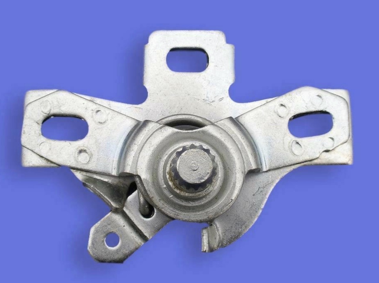

Hey Clay - had a quick look. 55-57 door release mechanism is a bit different. Look like they mount the other way up. Spring might be the same?. Don't know at this stage if I want to pay $28 USD plus shipping to find out ;)

Hmm. I wonder if later model holden would substitute. Might have to check Dudley's.

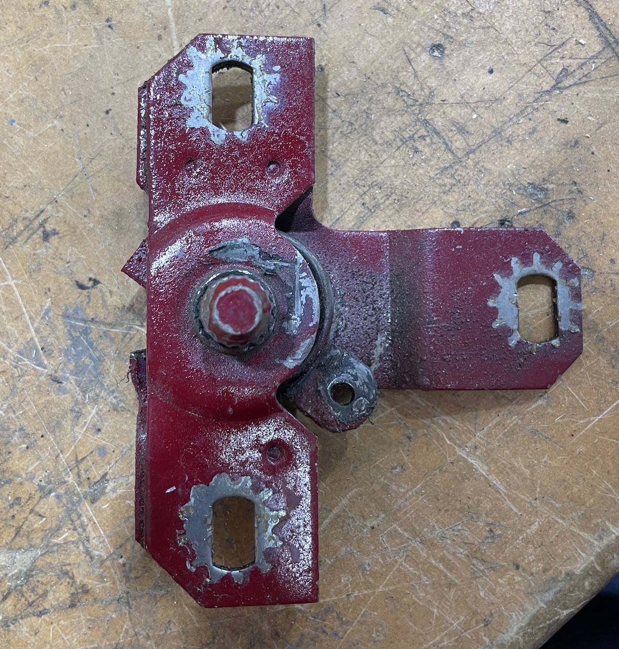

Got the hand held milling machine out - this is what I found
EH one looks to be similar but not the same , housing is well different - springs seem to be wound opposite direction , without having a set of EH doors I can’t say for sure as I am dependent on the labelling of the parts I have for info
