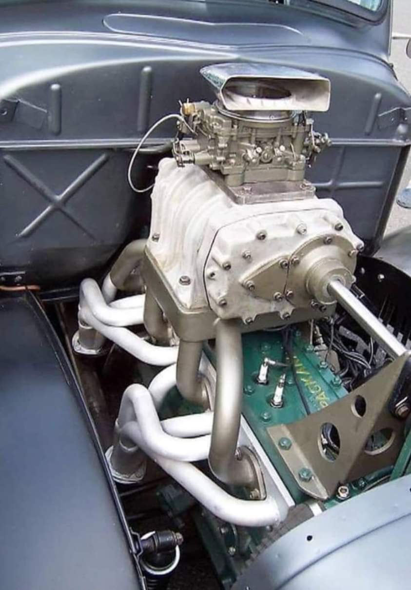

Re: Red Motor Manifold and Twin Stromies on 138 Grey?
Not mine … looks to be a banger motor. Borrowed the photo from another forum.
