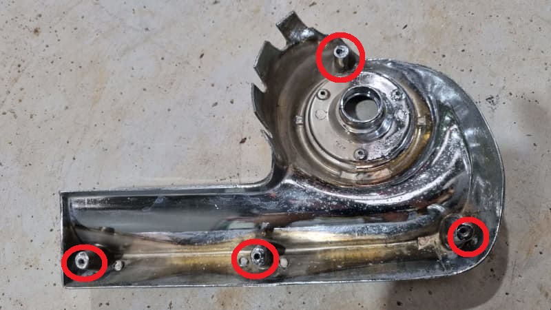

Hi has anyone got a drawing of the blow up of the EK parking light assembly. Is it just attached to the fender and grill?
Thanks for any help.

They bolt onto the guard.
Work from inside the wheel well (easier with the wheel removed).
Three bolts along the top, and one at the bottom on the end of a piece of round bar.
indicator bolts.jpg (91.8 KiB) Viewed 9747 times

There is a feller reproducing the long bottom mounting tubes. Try ebay or Facebook if you need them.
