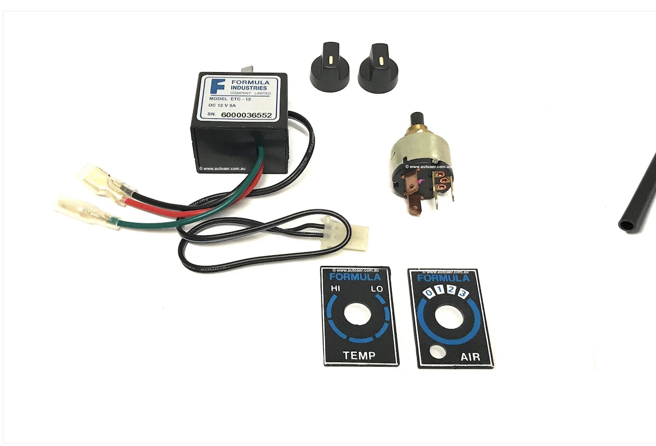

If I have got this right, the controllers are those two seperate bits with the wires. I could mount them anywhere there is room for them. I haven't got the kit yet, just planning.
I think the plan is to put the box somewhere hidden and run hoses to demister and where you want heat and cold air. In that respect I think space is going to be a problem under the dash. It might be I have to go with the old Mk4 type under dash setup.

Yes it pays to click on the itty bitty pictures below in the main link you posted.
Screen Shot 2022-06-23 at 2.22.41 pm.png (519.87 KiB) Viewed 14805 times
Not attractive - but small enough to be tucked away. Maybe in the ashtray.

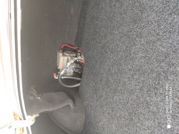

by briby
Update photos9.jpg (59.64 KiB) Viewed 14768 times
Hi Brett, this is mine tucked away in the corner of the boot, keeps mine cool, small enough to mount nearly anywhere. A bit Xy these days but keeps the engine bay a bit tidier.

An electric compressor certainly worthy of consideration. You will need a decent alternator to handle the current draw. Donโ€™t think the 20A generator on the old grey will cut it ๐Ÿ™
