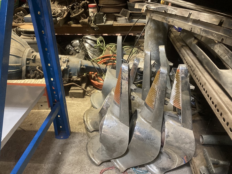

I need to clean out my shed ! What problem ????
IMG_0793 (1).JPG (234.28 KiB) Viewed 11867 times

Just ask her how many pairs of shoes she has Greg......ImageImageImageImage
FB ute driver, EK van project
Re: Steering rack conversion
Posted: Sat Oct 09, 2021 7:22 pm
Shit, where's me chromies gone?
Posted: Sat Oct 09, 2021 7:23 pm
Phew. Hiding at the back.Image
Posted: Sun Oct 10, 2021 7:30 am
Gee Greg, those barn-find taillights were selling for $400 each before the Nats. They are rare, and Holden doesn't make them anymore. Your shed must be worth a fortune, like mine :roll: :lol:
