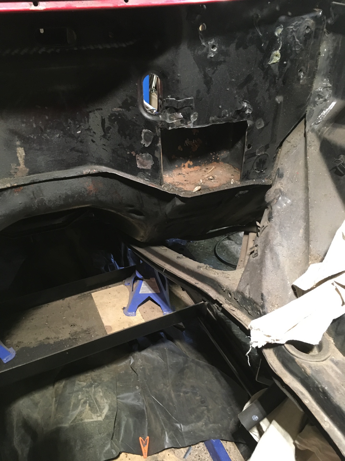

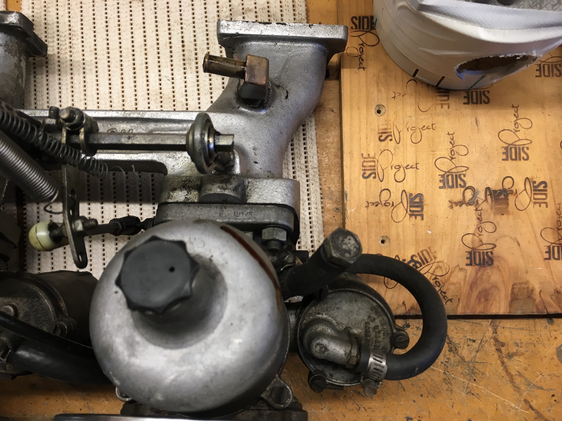

So too a trip down memory lane and got the carbies out to have a look. Also took a couple pics of the box in the firewall. Looks like overkill but the SU still managed to knock against the firewall after the engine rebuild. Maybe new engine rubbers had it sitting a little higher. 3 fuel filters seems like overkill! Must have had an issue with dirty fuel. That regulator (set at 3.5 psi) is a death trap. Had one of those on the Karmann and it started spewing fuel everywhere.

Posts: 11669
Re: Triple SU
That’s pretty crude. I’m sure you will improve it now you have the patience that comes with “maturity”.
funkyscooter
Posts: 725
Re: Triple SU
Post by funkyscooter »
Yeah its ugly as and a great little spot for fuel to pool up in the event of a failure. Done before my time.
