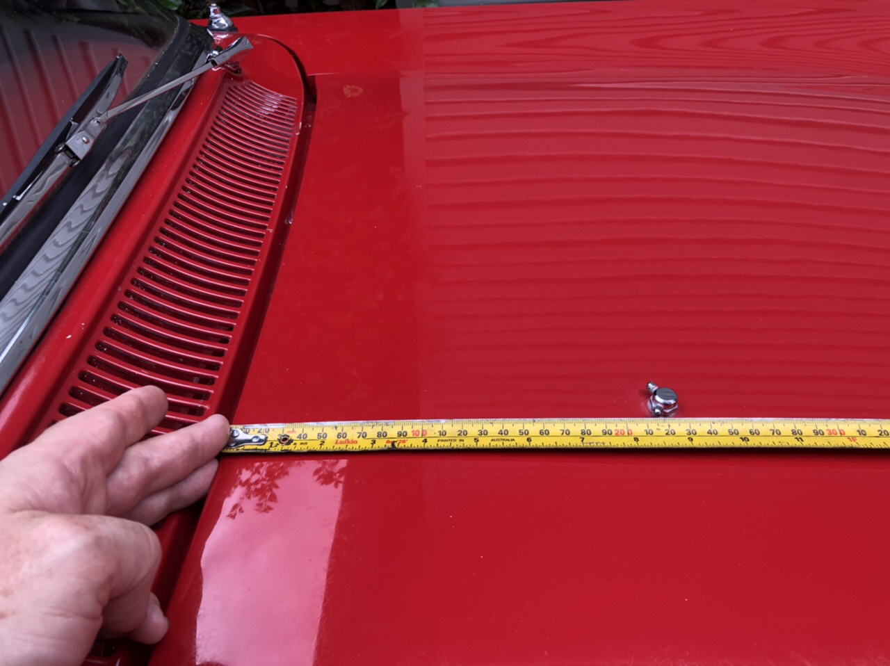

My bonnet came with the single-squirter hole. Can measure that for you if it helps, but no guarantee it is NASCO-correct. I don't have the instructions for the EK washer kits.
Re: Bonnet mounted windscreen washer squirter
Posted: Fri Jan 22, 2021 4:39 pm
8.75” from the trailing edge of the bonnet to the centre of the hole.
