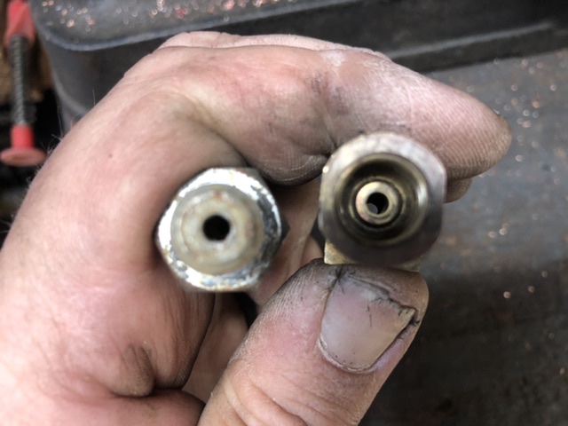

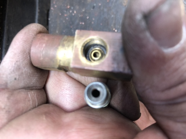

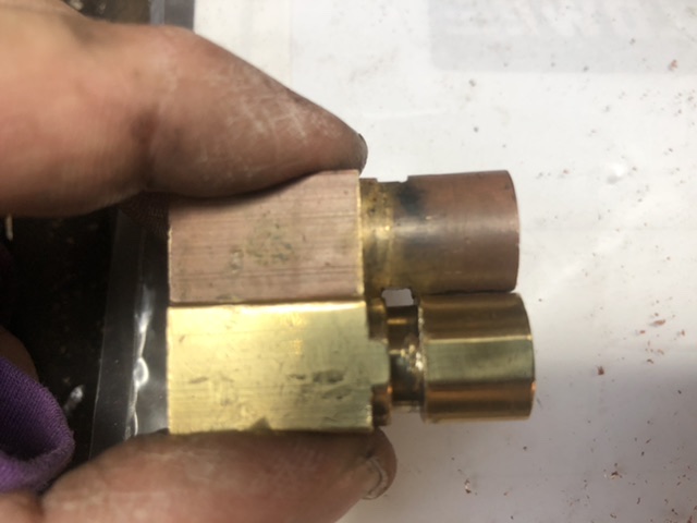

Got under the house, and pulled out the original FB brake block. The retaining clip groove is different, but otherwise identical to the leaky one.
The hose connection port is 7/16-20UNF, drilled to 0.34” deep, and has a raised flat seat to mate up to the hose.
This is different to the two pipe connection ports, which are 3/8-16UNF and have a 45-degree inverted flare seat ready to accept 3/16” tube.
The hose is threaded 0.47”, 0.11” longer than the 0.34” deep brass block (i.e. the hose bottoms out with a 0.11” gap). A typical 70-thou crush washer will not fill the 0.11” gap. Instead, the square hose nose seats on the internal flat seat. This is different to the front brakes (for FB/EK the rear hose and two front hoses are same same). The front brake cylinders are threaded 7/16-20UNF ready for the hose, but drilled 0.63” deep with no seat. The hoses thus bottom out with no seat to land on and need the copper crush washer.
I could find nothing wrong with the hose, nor either brass block. Put it back together with the FB block, and it appears to be holding tight. Maybe there is a non-obvious flaw in the first block, maybe one of the flares was not right and leaked by dripping off the hose, or maybe the FB got a little scared when it saw me lay into the diff filler plug with a cold chisel. One for Scully and Mulder 👽
