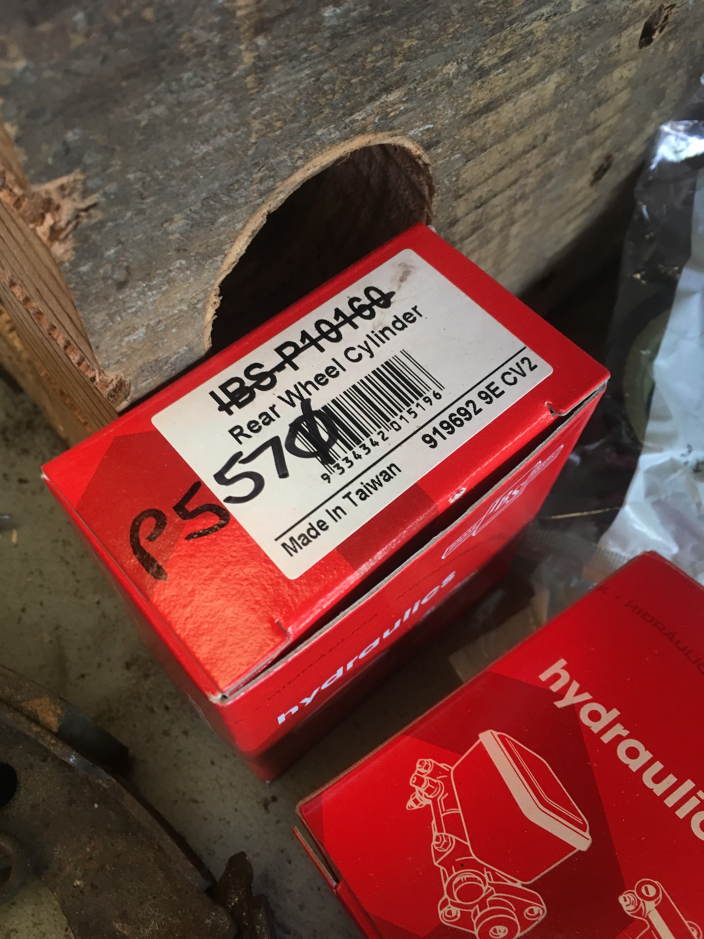

So I have a HR diff in my FButEKsedan. When I stripped it down last year I replaced the rear wheel cylinders with the HR option from Rares.
This is the box they came in
Wheel Cylinder Box.JPG (712.35 KiB) Viewed 12769 times
Here is the new one compared to the old one.

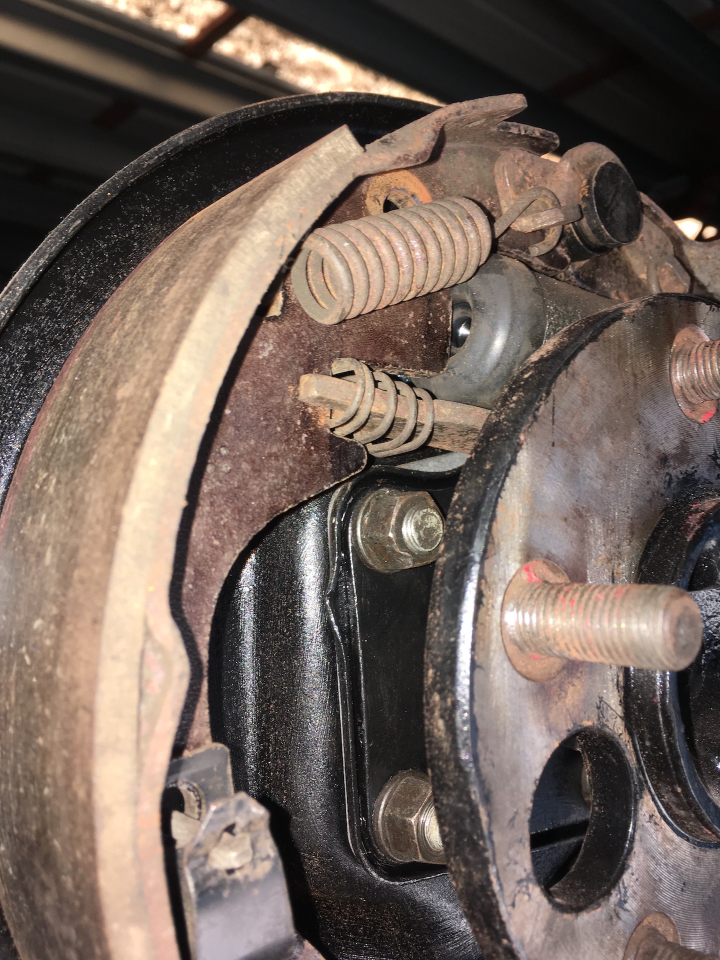

Clearly different. But hey rather than question it at the time - what the hell, lets install them anyway! Maybe when you press the peddle the piston will push out?
Cylinder Installed.JPG (822.96 KiB) Viewed 12769 times
Well still haven't fit the diff back into the car but the shoe/cylinder combo just looks wrong.
Any ideas?

Rares part on the invoice was 7420771, "Holden Cylinder Wheel Brake Rear with Drms EJ EHHD HR LC"
Re: Rear wheel cylinder identifcation HR Diff.
Posted: Wed Nov 25, 2020 1:47 pm
by ardiesse
Scott,
You have managed to get the rear wheel cylinders for 4-wheel-drum-brake cars.
You want 9/16" bore rear wheel cylinders, which are for cars with front disc brakes.

Thanks Rob - So when I re read the invoice that makes sense!
Oh well - anyone need a set of rears let me know. If not I'll stick them on gumtree.
