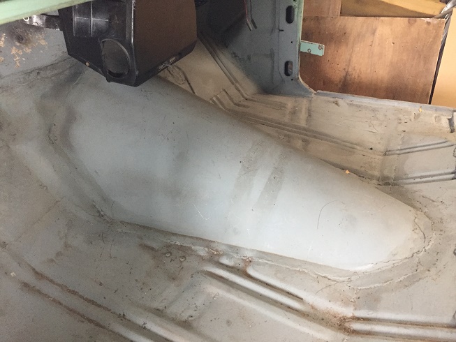

A caution on CRS tunnels as there are big enough to take a turbo 400 box.
I run a M21 in the wagon but this was done by the previous owner.
This is the wagon with bent shifter that misses the seat, just.
wagon tunnel.JPG (169.02 KiB) Viewed 1628 times
This is CRS tunnel in the ute, whihc will have trimatic box.
CRS tunnel.JPG (116.43 KiB) Viewed 1628 times
Hope this helps.

Thanks Roger. Great photos.I was worried that the CRS Tunnel was so large? I did think about fabricating my own and yes I believe that I will need a 1 tonner shifter if I dont want to cut the seat. Ill probably just modify the shifter to suit the seat I have once its in.

The tunnel has been cut down the centre and simply spread apart. Piece of metal.was welded in underneath where the strengthening rib used to be. They just left it split open?? Yep there's a large split down the centre of the hump. The inspection plate has been modified with a large persuader. Its all a bit a dodgy. In saying that if I was the first man to ever modify one of these for the larger box my theory would be to split the tunnel.down the middle from the bottom of the inspection plate to the end of the tunnel. Cut across the end of my longitudinal cut at 90deg and spread the tunnel. Then add a section of metal into the hump. The inspection plate would also be split and bolted in and add a section at the bottom using the same process as above to achieve the desired fit. That way it would still look ecactly like a stock fb floor albeit slightly wider. You would have to do a double take on it to realise it. Given that the work is half done i might try that? Worst outcome is i have to get a CRS tunnel if all else fails. I'll post a photo later today.

It gets down to the floor covering you plan to use. It is said that the after market carpet available fits the crs tunnel ok. Might be the EK hydramatic version. I'm putting a reproduction rubber floor mat in my van so I used a cut from a hydramatic. The hydramatic cuts aren't that easy to come by.
What you describe is how I've seen tunnels done going back. Nothing wrong with it if it's tidy but you need to strengthen it to more than make up for removal of the strengthening. Some use thick flat bar but this doesn't have torsional rigidity of a box section. You can run rails back and up from the rear of the inner subframe mounts either side of the box to the floor pan seam under the seat. These also serve to mount the rear crossmember and emulate the hydramatic setup.
Obviously you want to ensure forward movement of the seat is not impeded.
