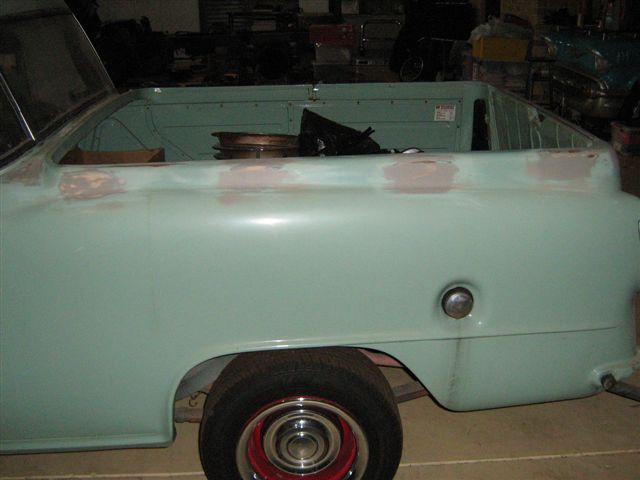

A couple of weeks later it arrived and I actually drove it off the road and into the carport.

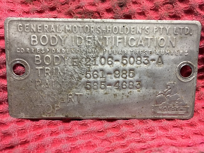

Body number;

Although in pieces it looked OK and it would not take much to get it together and registered.

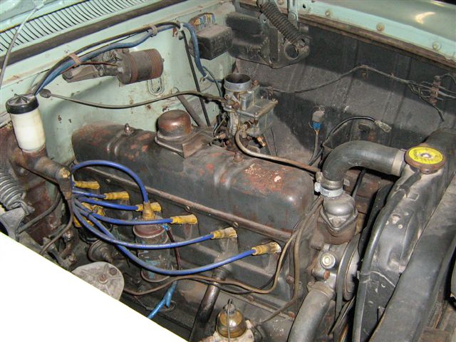

Drive line currently is 202 with trimatic but I like to sound of a V8 in the ute.
Still time to change as exhaust not sorted, small change to cooling and wiring looms to be built.

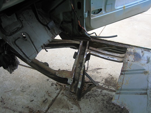

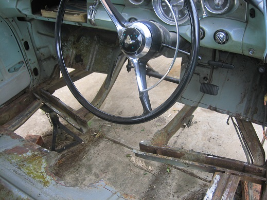

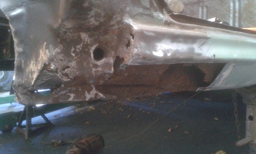

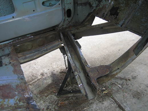

As what appeared to be a good start on the rust, quickly turns sour on closer investigation.
Doors did not line up at bottom, sill repaired with bog, etc.
It was a little crunchy under foot so pulled the carpet and found floors rusted under the fiberglass batches, so out they came.

Added crush tubes for future chassis rails.
Floor 9.JPG (111.99 KiB) Viewed 38891 times

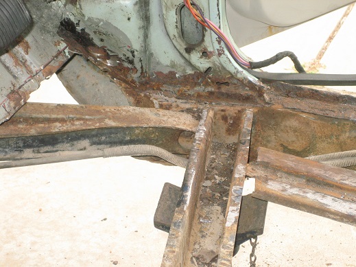

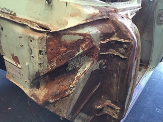

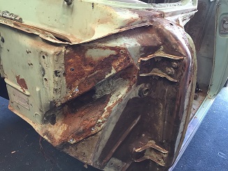

Pulled the front clip off and found more.
Front rust 1.JPG (47.77 KiB) Viewed 38891 times
Front rust 2.JPG (49.62 KiB) Viewed 38891 times
Front rust 3.JPG (54.07 KiB) Viewed 38891 times
By now I’m a little concerned with the quality of any previously repaired sections and my " quick " turnaround look out of the window.

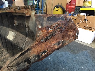

A couple more photos of the rusty sections

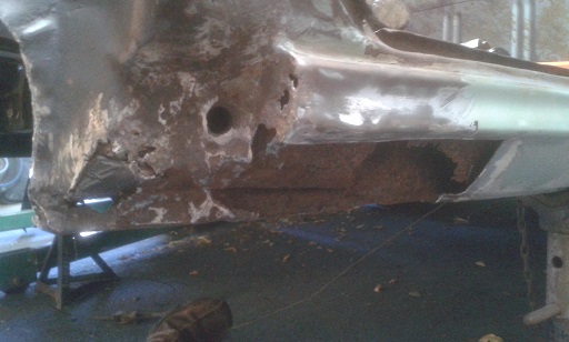

Front rust 4.JPG (59.31 KiB) Viewed 38888 times
Front rust 5.JPG (50.68 KiB) Viewed 38888 times
Sills 1.jpg (56.3 KiB) Viewed 38888 times

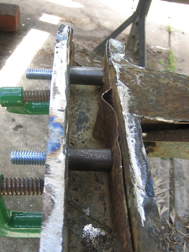

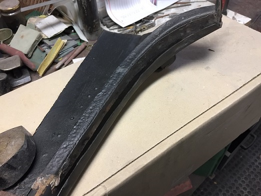

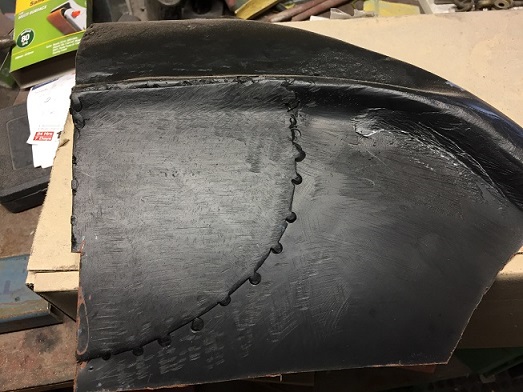

I cut out these and purchased patch panels from Rare Spares.
Guard 1.JPG (80.13 KiB) Viewed 38888 times
Guard 2.JPG (83.77 KiB) Viewed 38888 times
Guard 3.JPG (89.71 KiB) Viewed 38888 times
I thought you only over lapped when spray painting not doing rust repairs.
Made the mistake of welding these in on the bench. When I fitted the guards to the ute the panel were out of shape.
I had to cut the welds open to relax the metal and then slowly re-weld. Another lesson learnt.
