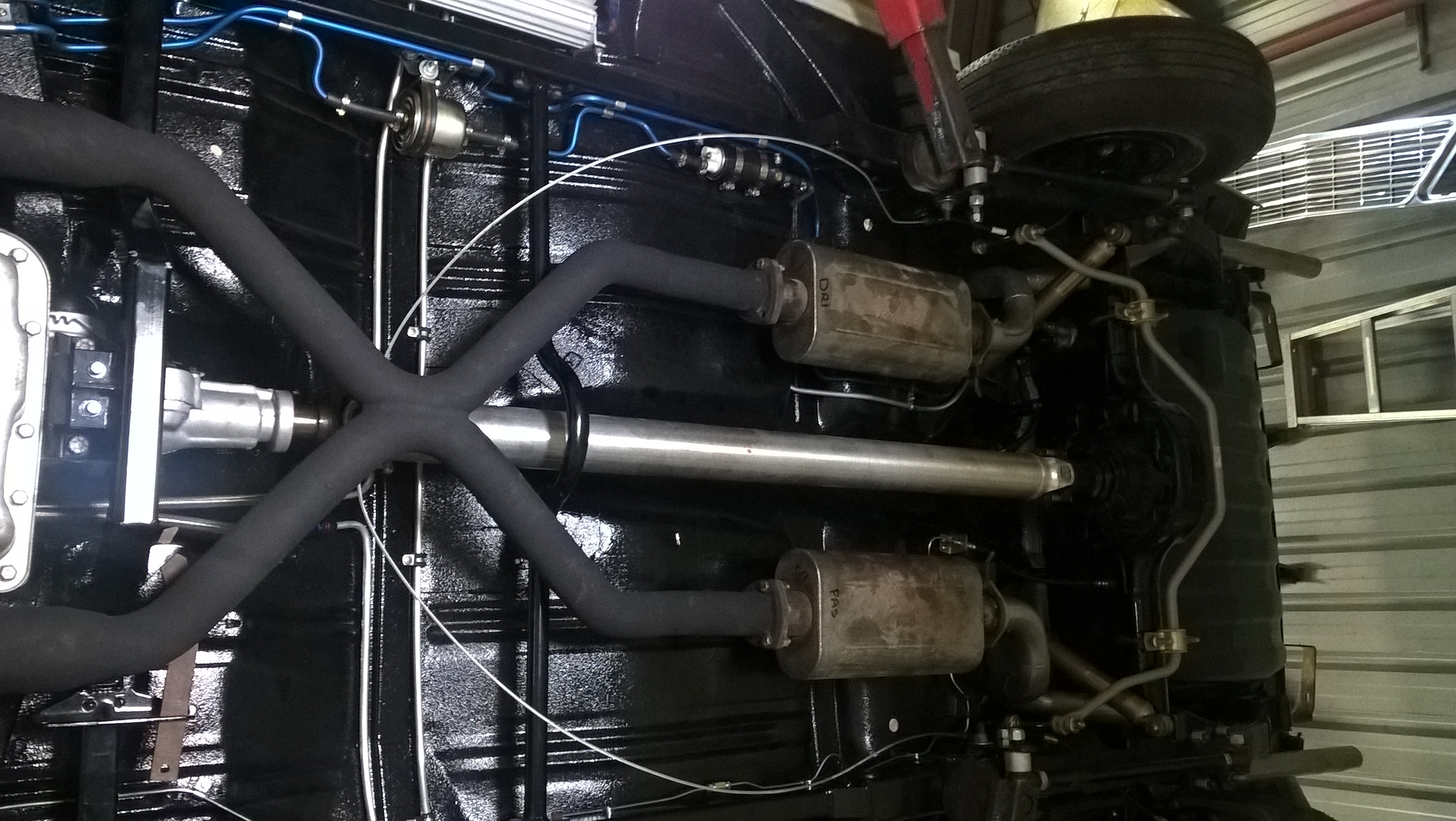

Posts: 2661
Re: Any one used Holley sniper EFI self tuning
This is how I ran my fuel lines underneath along the chassis rail.
http://www.fbekholden.com/forum/downloa ... hp?id=9143

Greg ive not heard of the Holley projection either but have been reading up about it tonight , thanks for the pic your undercarriage looks alot beefier than mine
