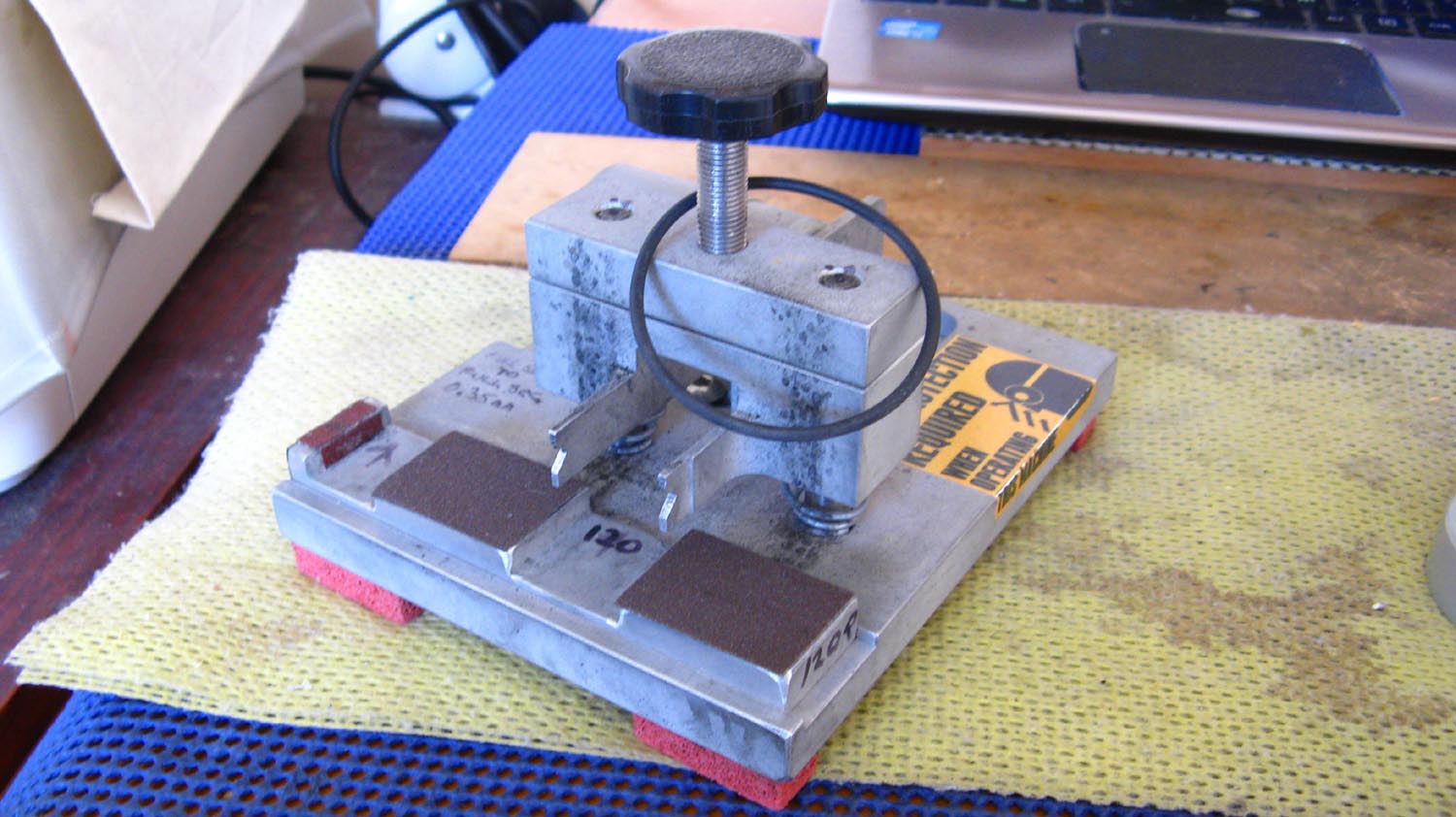

Temporarily fitting axles with wheels and tyres so that the guide height could be determined and soldered into place was next...
The tyres were glued to the alloy rims and a "tyre truer" used to get all four tyres down to within 0.5 mm of true scale diameter had to be done before I could set the guide height..... the height of the guide with braid fitted was set so that it made equal contact with the set-up plate.
That set up plate was made from 1/4" steel and a slot milled out for the guide...
Many might not know this, but Allan Moffatt had such a set up plate in his home workshop... it gave him an edge on most of the competition - he set each wheel and spring compression to suit the track which was to be raced on next....
If you have not read his book - I would highly recommend it... it is a very sad story - I felt very humbled for the man....
