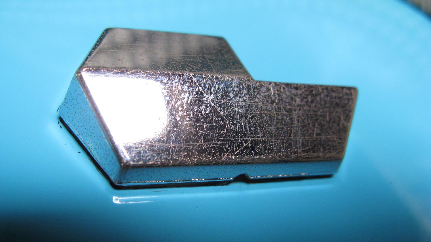

With the rear, I was lucky to get them off without breaking any - I used a very thin gasket of neoprene between the letters and boot-lid.. and Sikaflex 221 to put both the gasket and letters back on...
Further, I used a Dremel machine with a fine diamond bit to grind out drainage ports in all the letters.. see pic.
Poor pic, the chrome is a lot better than it looks in this pic - angle was wrong for the available light - but you can see the letter in place on the boot, the thin neoprene and the drainage port...
