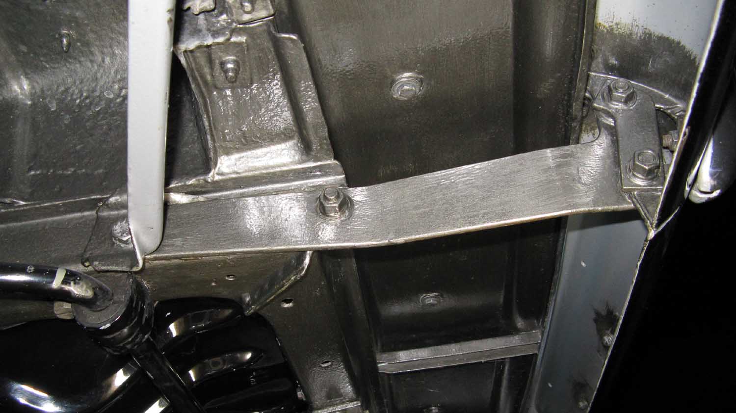

002 rh iron marked mail.jpg (105.02 KiB) Viewed 865 times
In this pic, I have marked out the measurement from the sub-frame end where the bends in my irons are...

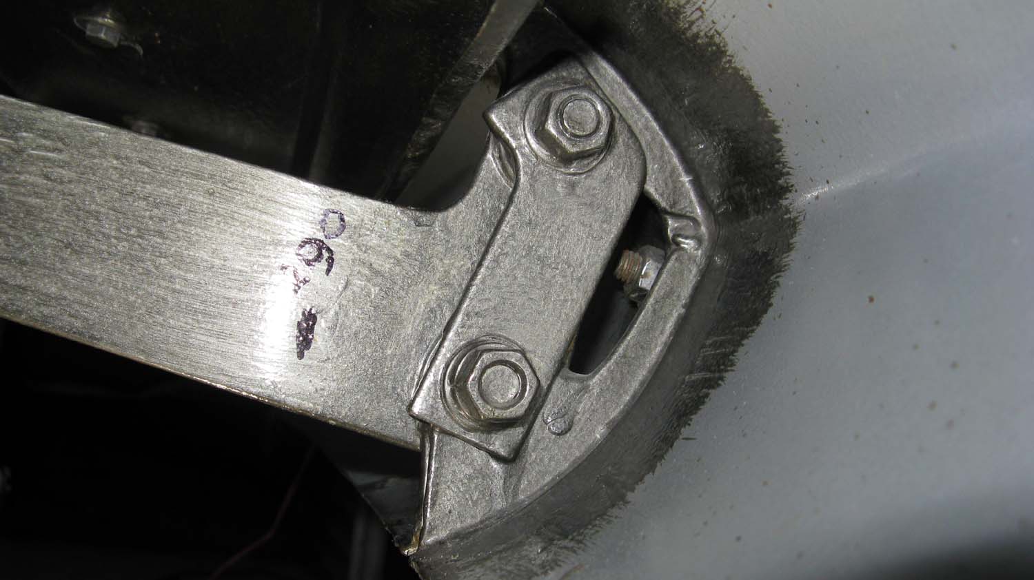

003 rh plates mail.jpg (110 KiB) Viewed 865 times
This pic shows the plates which sandwich the iron.. I don't know if I have the hooked end of these the right way up... but it works..
