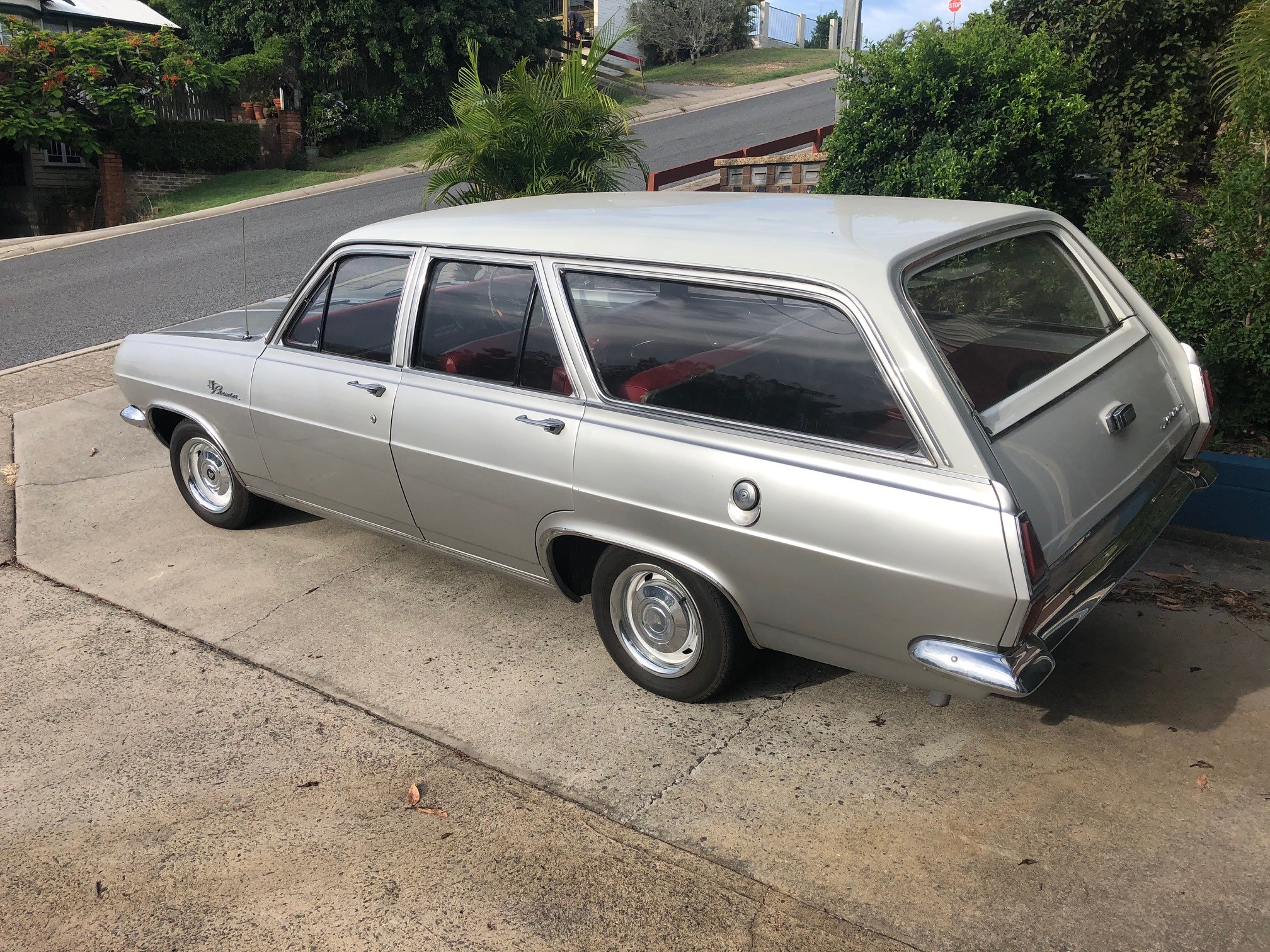

HR Holden side.jpg (1.11 MiB) Viewed 23413 times

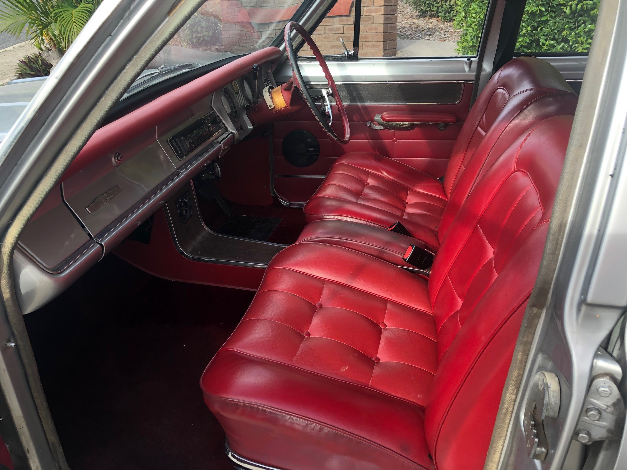

HR Holden front seat.jpg (590.68 KiB) Viewed 23413 times

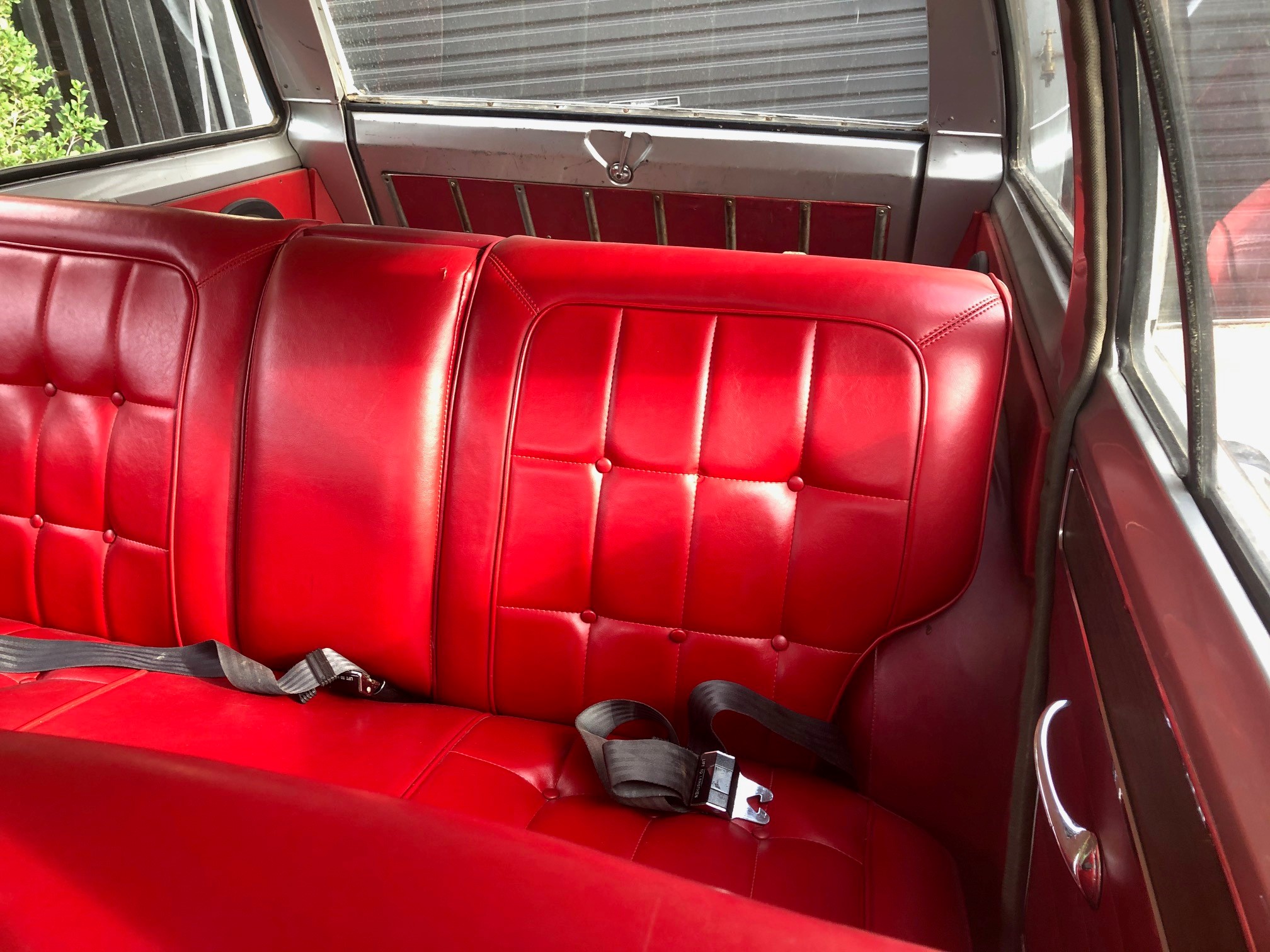

HR holden rear seat.jpg (549.35 KiB) Viewed 23413 times
Fairly original, but some minor butchery that needs to be fixed. Looks to be correct 186 engine, single Strommie, drums, open-centre banjo. The Glide has been replaced with a Traumatic. I'll post some more pictures as I play with this one. Lots of fiddly stuff to sort out, and I am no HR expert... will need some help to work out how it should be.

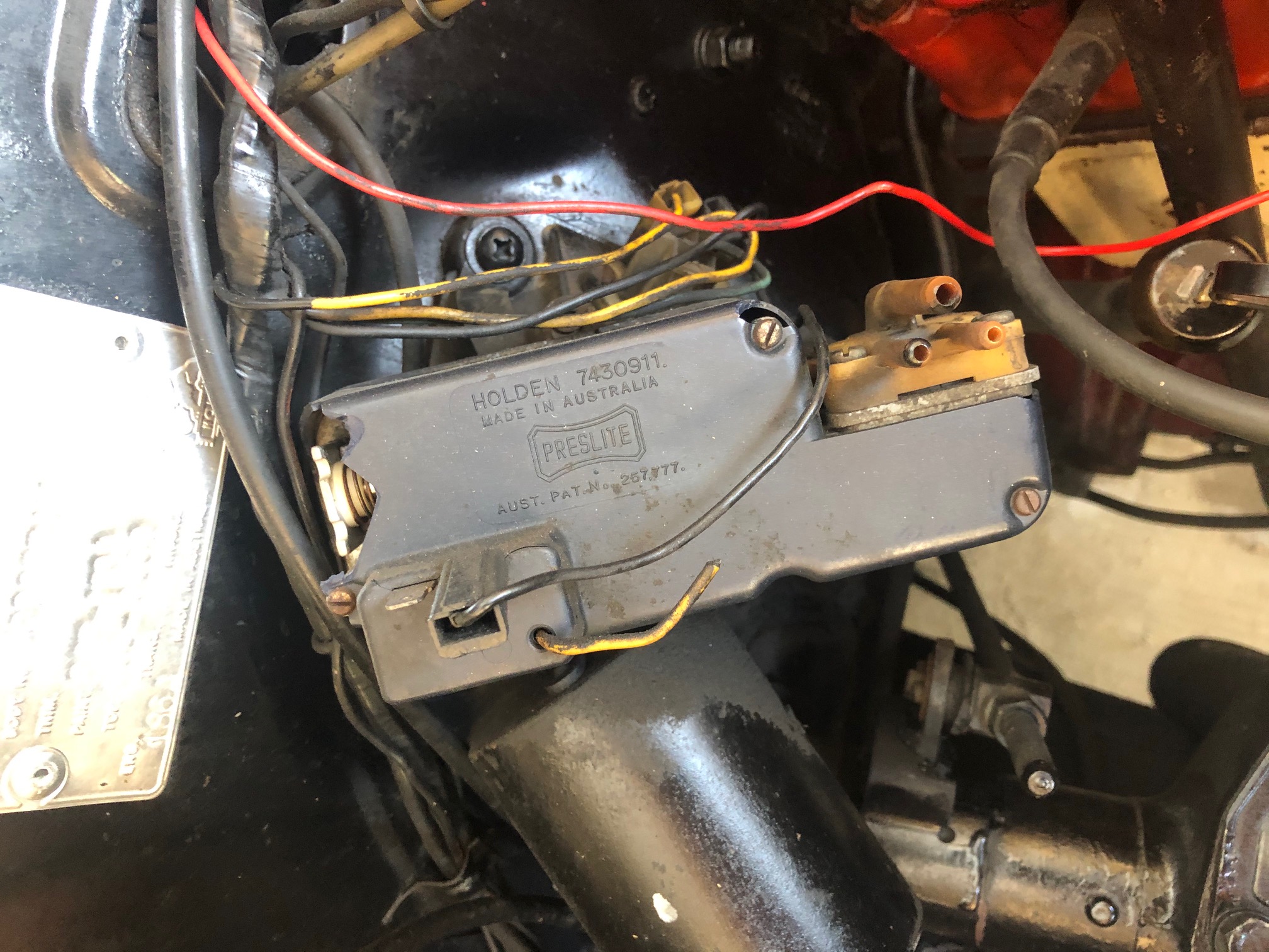

Thanks Blacky. The washer motor looks like this:
windscreen washer.JPG (708.35 KiB) Viewed 23306 times
It's been disconnected, but I don't know yet how damaged it is. Someone has put a later-model plastic bottle/integral pump type onto the inner guard (close to the radiator), so I suspect I am missing the washer bottle too.
The wiring in this thing needs some attention... anything disconnected has just been cut off with sidecutters :thumbsdown: I've got a few hours of fun with the Fluke meter and crimper.

Repair butchered Preslite windscreen washer pump and remove aftermarket washer bottle/pump.
- Good luck. Even in the mid '80s, they were almost impossible to repair. The Preslite Synchro-Squirt(TM mine) washers were a triumph of engineering, a joy to behold when working, but chronically unreliable. Under the blue plastic housing is a cam on the output shaft and a solenoid. The solenoid engages a cam-follower which actuates a good old-fashioned diaphragm pump with check valves. The rubber diaphragm perishes, and the check valves give up. I managed to get a valve body from a Torana wiper motor in '85 (so "only" about ten years old), which still had working check valves. I still have a couple of Preslite wiper motors.
