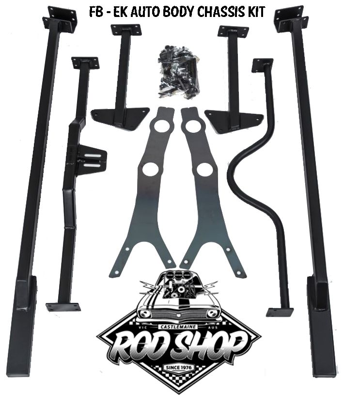

You can go silly and put in a fancy rear end (four link etc) to get it to hook up, though for a cheaper option:
a) put a set of 3/4 chassis rails in from the front floor brace back to the rear spring hangers (the two pieces of steel on the left and right hand side of the image below). Castlemaine Rod Shop sell them:
https://www.rodshop.com.au/holden/fb-ek ... s-kit.html
though they are easy enough to make... little more than glorified lengths of RHS though are weld-in to the rear spring hangers. The braces make it easy to fit a DIY tailshaft loop, which will keep ANDRA happy.
CRS kit.jpg (67.82 KiB) Viewed 844 times
b) put a set of braces in from the front floor brace forward to the subframe K-members. Castlemaine sell these too (the two bits in the photo above with triangular plates), though again easy to make and are bolt-in.
