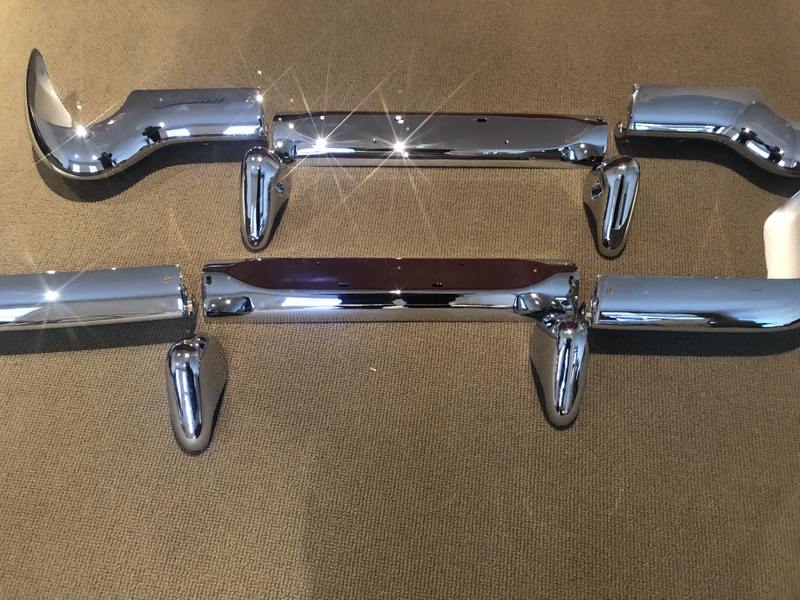

With die cast re chroming a lot of time goes into the copper work as its dipped and polished to rid any imperfections and this can take several copper dips. Once that's done then nickel and then chrome is usually used.
The bumpers if work is needed are hammered, pressed welded etc then sanded smooth, once again triple plated with copper nickel then chrome. Some places will use inferior solutions to keep costs down and many bumpers come back with scratch marks etc in the metal because of the time and cost involved in the prep polishing.
Just as a guide my bumpers cost $1100 each, meaning 3 pieces plus the overiders as well as some small repairs and courier costs.
This also took 5 months to do.
My die cast pieces have been with another chromer for 6 months and as a guide again $1500 for the blinker surrounds, front bar, rear lights, and mirror stalk. I don't have these back yet which has been good because I have had time to save the money.
