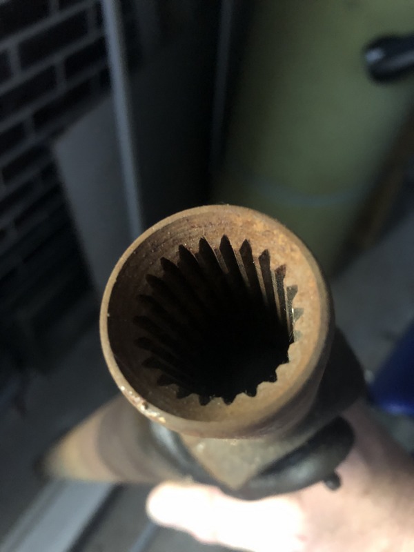

Re: Wanted : Tailshaft slip yoke (gearbox end) to suit hydramatic
Hi Dan,
I am sure I have one I will look and take a photo for you.

Posts: 2710
Dan,
Send me a PM if its what you need.
Its got a bit of surface rust but I can linish it on the lathe.
Posts: 2710
Dan,
There appears to be 2 thickness sizes, assuming different housing bearing and seal.
I will measure the yolk tomorrow hopefully its the same as the EJ.

Posts: 2710
OK more study,
The measurements in the book are of the ground length section of the yolk not the thickness.
Mine is the longer one marked as EK but I am not sure if that will make any difference or not ??
Post by DanFranko »
I completely forgot to update this post.
My gearbox guru here in Perth was pretty adamant that they all fit between EK—EH. The yoke that Greg sent was the correct size, but as we suspected, it was flogged out at the uni joint when it seized up. So it was unusable, but remains a good spare to use to
Identify another if needed.
The problem was actually the rear extension seal. From what he explained when you order a modern replacement they are a metric diameter - it fits but leaks as it’s ever so slightly too large. He had to source and imperial one and that solved the problem. He got me a spare so I know what one is in the car should I or someone else need one.
