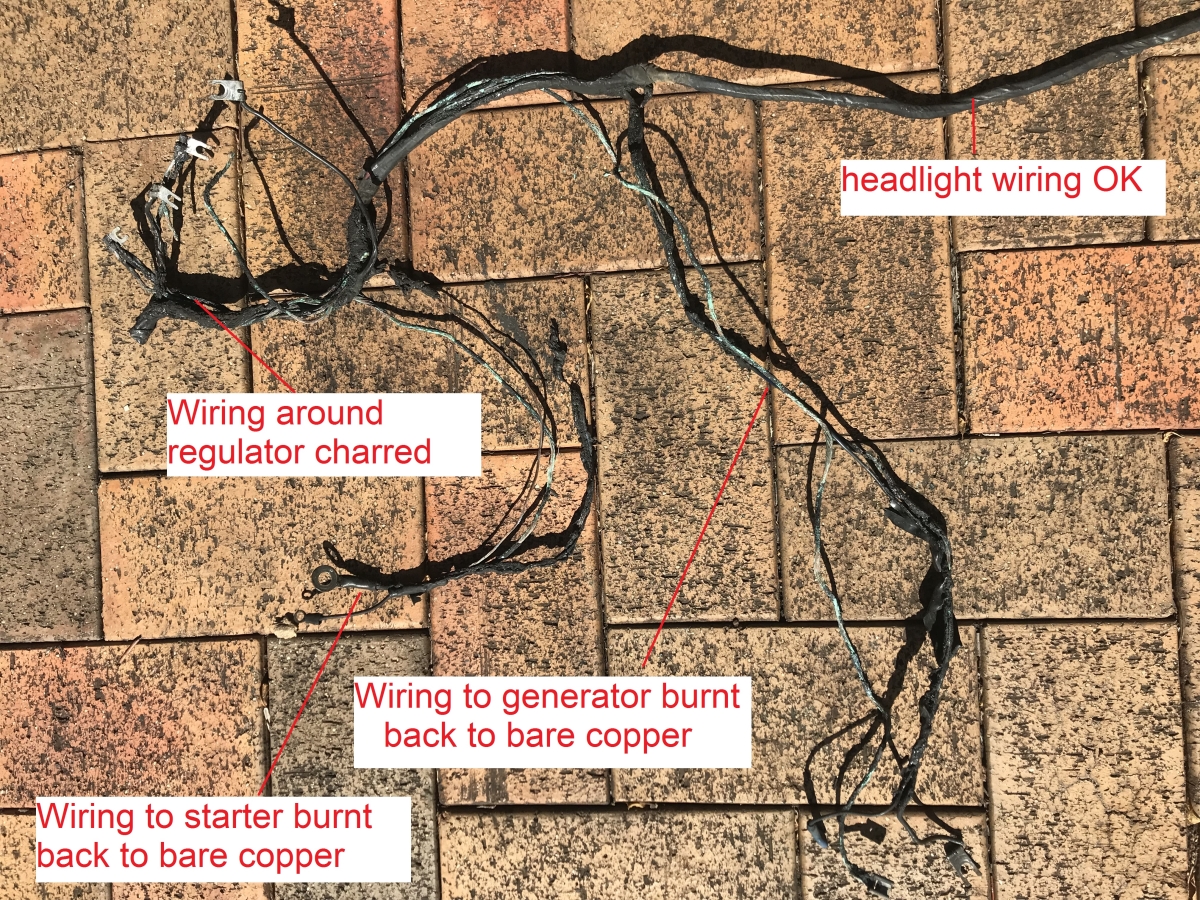

Number 1 Son's VL has been off the road for the last month or so. He managed to spin #4 main bearing, so a full rebuild was in order. In the meantime, he has been thrashing driving the FB. Most of the stuff that he has been broken is probably coincidental. Got a phone call from him a few days ago to tell me that the FB generator light was staying on. Fan belt still in place and tight... doesn't sound good :( .
Got myself home, and checked under the bonnet... not pretty. The firewall around the generator reg has black soot, and there is a good circle of soot underneath the bonnet. The D and F wires that connect the gennie to the reg are burnt out - bare copper. The wires either side of the reg are heat affected. Looks like the gennie has spat out a heap of amps, and the wiring did not handle it. Lucky she didn't burn to the ground :wtf: . I don't know what worries me more - that it could have burnt whilst unattended, or that it burnt while Number One Son was driving it. Neither case good.
I have run the car for around 7 years now. About 4 years ago she did a fully-laden trip up to Taree (4 kids and a trailer), and managed to boil the battery. Topped the battery up and putted around for a fortnight before coming home. Got as far as Newcastle and the gennie light came on. NRMA came to take a look, and played with the contacts in the reg. Suspect that he had less of an idea than I did, and pushed close the contact that prevents the battery backfeeding the wiring - all the magic smoke came out of the gennie. He was more than a little sheepish. Car came home on a tilt-tray, and I fitted a gennie and reg from the spare parts department. Being stupid, I did not check either :oops: . Drove OK for the next 3 years, though tended to kill batteries every 18-24 months. Had a new battery in it this winter. Battery was working OK, though the "see through indicator" occasionally went clear ("bad battery" indicator) and occasionally could hear "fizzing" after shutting the car down (my bad... should have investigated more).
The FB has been parked in the naughty corner. Will replace the wiring and take out the reg and gennie in late January. Know I have a spare reg (the one from the Taree trip above), and suspect I have a gennie. Might do the smart thing this time and get Rob's help (please) to run them over the test bench before installing.

I think what's happened is probably a D+ to DF short in the wiring (if Prince of Darkness) or a DF to ground short (falls deine Lichtmaschine aus deutscher Herstellung ist). The fact that the DF wire at the generator's fried suggests that it too took some serious current. With the fault in the wiring, the poor regulator will have been unable to limit the generator's output, and the "fuse" in this case will be the generator's field coils, which will have gone open-circuit. Unfortunately the regulator's collateral damage. The short occurred, then the field coils burnt out, and only then the generator light came on.
It'll be some fun unwrapping the wiring harness and replacing the cooked wiring.

Autopsy Results: Internal short from D+ to ground, occasioning over-current fault in the armature with consequent rapid and terminal effusion of smoke followed by death.
OK, then. Something went wrong at the back of the generator. The plastic insulators that insulate the D+ brush holder from ground got hot and softened. Under brush spring tension, the brush holder rotated outwards until the head of the brush lead attaching screw contacted the frame of the generator. Now we have a direct short to ground. At this point the short is supplied by both the armature and the battery.
Armature first: Rapid overheating with charring of both insulation and slot wedges. The slot wedges partially fall to bits. The armature still produces current, because in this model of Lucas generator the coil ends are staked into the commutator, not soldered. The positive brush lead melts and isolates the armature from the short circuit.
Battery second: The battery joins in the fun once the D+ terminal goes short to ground, and still supplies current into the generator after the brush lead burns out. The wiring from the starter to the regulator to the generator overheats and burns. I would have expected the regulator to notice the reverse current from B+ to D+ and open the cutout relay, but it didn't. Maybe the contacts welded shut. The cutout relay and current regulator now smoke up. At some point the short circuit is cut (maybe the regulator contacts opened?) and the smoke stops coming out.
