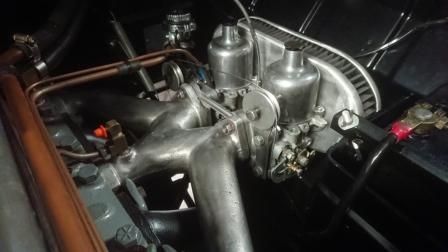

spent some time tweaking the strommy but couldn't get it to run well with power, the Jet that was in it was a 0.037 tried a 0.051 but when I put the foot down it was like turning the ignition off it just dies, tried a few other combos but nothing was all that good
Decided to go with the SU's, had a old set of extractors in the back of the garage so I bolted the setup onto a engine that I had on a stand and modified the exhaust to fit with a bit of cut & weld
had to manufacture a throttle cable bracket, my existing cable was to short so I used one from a VT without too much modification, return spring bracket and a 2 to 1 choke cable.
went for a spin today and it was great, not flat spots heaps more power and very smooth
Now my question is
I went to tune the carbs with vacuum gauges but couldn't find any vacuum, what I thought was the vacuum advance outlet didn't have any vacuum on it (checked for blockage) pic with arrows pointing to the outlets
1. can I just drill a hole and tap a thread into the manifold to create my own vacuum advance port ?
2. could I just tap off the feed to the PCV valve or would the gasses be too dirty and cause problems with dizzy later
3. forget it and be happy with wot I got ?
still needs a bit of a tidy up

I’m no expert on SUs but that won’t work. The advance needs vacuum “signal” from the Venturi rather than manifold. Needs to be ported before the throttle valve.

The original B-Model carburettors used on early Holdens had a vacuum connection (a steel line) that connected from the carburettor, snaked it’s way around the rocker cover and connected to the distributor vacuum advance. This connection needs to be replicated in multiple carburettor setups like your twin SUs, but can be left off if needs be. You will lose some fuel economy at cruise, but little else.
When thinking about this vacuum line, it is important to realize that there are two types of vacuum commonly tapped off a fuel system:
• Manifold vacuum (sometimes referred to as full vacuum), which is used for brake boosters and vacuum wipers. It is tapped off from the inlet manifold, or on the carburettor throttle body at a position below the throttle plates. You get more manifold vacuum when you take your foot off the throttle (this is why pre-EK vacuum wipers work so well when you lift your foot, but run poorly when you have your boot into it driving uphill in the pouring rain!).
• Timed-spark vacuum (sometimes referred to as distributor vacuum) is taken from above the throttle plates. Timed spark vacuum is exactly the same as manifold vacuum – except that it is shut off under zero throttle (i.e. under idle conditions, there is huge manifold vacuum, but zero distributor vacuum). The strategy behind distributor vacuum (generally used in later-model carburettors) is to remove vacuum advance at idle, causing the vehicle to run hotter and combust exhaust emissions (often with the help of air injection systems at the exhaust manifold).
Early Holdens were designed to run timed spark vacuum (the vacuum port connection is at the throttle body above the throttle plate). There is no harm in running timed=spark vacuum with multiple carburettors (by tapping into one carburettor and blocking the other one off - tapping into both carburettors and using a tee-piece is absolutely unnecessary). However, for cars with large cams (high valve overlap and poor vacuum), tapping into manifold vacuum (and blocking off the distributor vacuum ports on both the carburettors) can give better vacuum signal at idle, more advance and hence better idling. This can also reduce engine temperature at idle.
The little nipples on the SUs that you have plumbed into are manifold vacuum. They are connected to a tiny drilling that comes out just below the throttle plate. The instant the throttle plate is cracked open, they become manifold vacuum. Unless the red has a monstrous cam, you should be getting lots of suck from these at idle. The drillings are fine, and prone to fill up with coke - use a bit of fishing line and see if they are clear.
Try not to use PCV fittings for distributor vacuum advance. You are correct - they are oily and wet, and will pool crap at the low ends of the hoses, unless teed off and run very carefully.
Options:
a) Try to clear the nipples. Block one, plumb the other to the vac advance.
b) Block off both nipples, block off the vac advance line at the dizzy and run no vac advance.
c) Remove the manifold, drill and tap to fit a nipple. Connect vac advance to new nipple.

Depending on what model SU you are using will depend on where the nipple is located above or below the throttle plate.
I'm running later 1 1/2 HIF Su's (38mm). The vacuum take off port for the distributor is located below the plate (manifold vacuum).This is done for emissions purposes in UK (Mini's).
I had to plug the existing port and redrill above the plate for ported vacuum. Ported vacuum is important as it advances the ignition when you go through part throttle which helps to eliminate flat spots during lean outs when you crack the throttle. Ported vacuum will still control advance up or down as load/throttle conditions vary.

Craig Allardyce wrote: Sat Jan 19, 2019 3:23 pm Depending on what model SU you are using will depend on where the nipple is located above or below the throttle plate.
From the look of it, he is running HS SUs ('62-'75). I thought all the HS castings were manifold vacuum on the little nipples, but I could be wrong.
