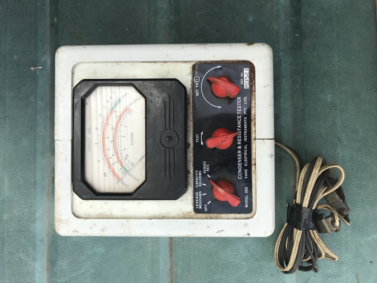

I've been slowly getting some electrical bits together, as I need to learn more about starters and generators (I also need to get the magneto test bench project going once the EK wagon is on the road). Worked out my little SuperCheap ammeter was not going to cut the mustard, so bought a decent Fluke clamp meter. Purchased a Vane condenser checker... can probably do this with the Fluke, but the Vane is neater:

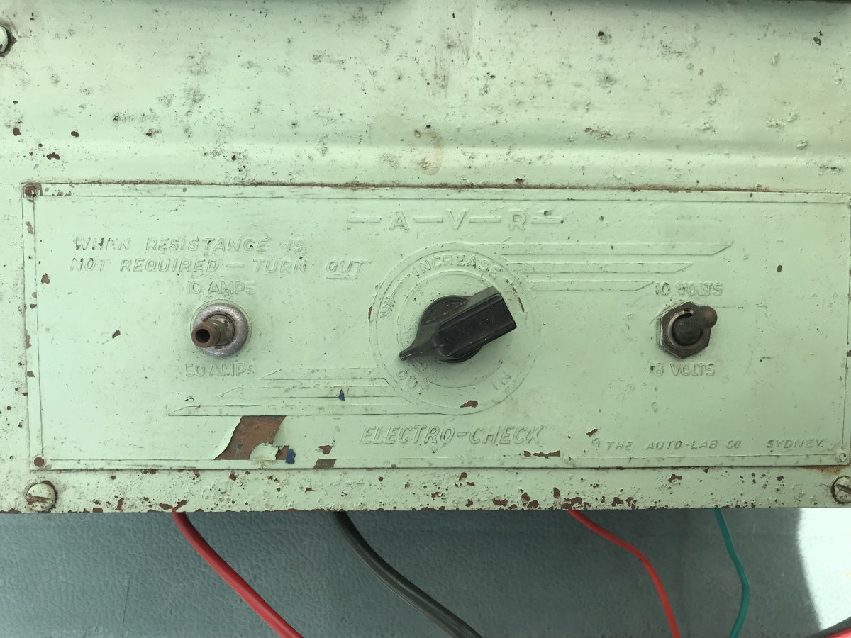

I managed to pick up a VRA made by The Auto Lab Co in Sydney:
It came with the box-of-snakes wiring shown in the photo above. The snakes were horribly perished, though when I opened the unit the insides were in great nick. I replaced the red and green wires, then got a bit worried as I didn't fully understand how the internals worked... my bottle of replacement Magic Smoke gets enough of a workout, so have not hooked it up to power yet. :oops: Might have to get your help at some stage please to understand this thing better. If you would like to run it alongside your test bench you are more than welcome.

I'd be glad to help re-wire the VRA box. The condenser checker looks like a nice piece of gear (but you can use a good-quality digital multimeter to the same effect).
You might have to check that the meter movements still move freely - it's a watchmaker's job to put the movements back on their pivots if the box has been dropped. The broken glass on the voltmeter won't be aiding matters either.
