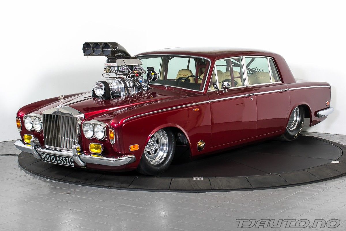

Errol62 wrote: Sun Jul 22, 2018 8:57 am Hmm 6.5litre alloy donk. Thinks..........
Gee that would really make the FB get up and go........ha.......ha......
Kind of like this, but in reverse?
First the RR people would get upset with you.
Then the Holden restorers would get upset with you.
Then you can park the Roller-powered FB at my place so I can appreciate it :ebiggrin: .
