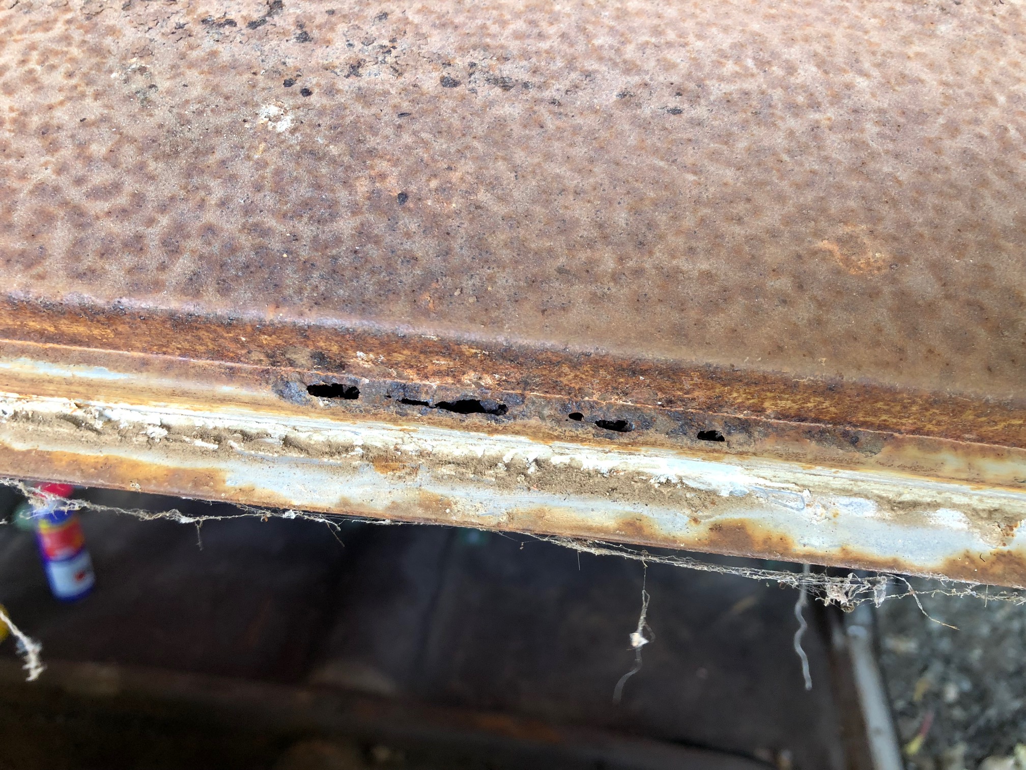

So ive started stripping the car down, the it is beginning to reveal its secrets. I've found a bit of rust in the body shell at the top of the rear screen.
The attachment IMG_0665.jpg is no longer available
I guess that needs to be cut out?

It is all fairly typical jonty. For the window opening you will be best to cut it out. Depending on the extent and complexity of the bit you remove you could make up a patch, fold a bit in the vice or cut a section out of a good roof. Patch panels are available for the guard rust.

The sheet metal-worker at work gave me a few hints about welding thin-gauge sheet-metal. Here they are -
1. Use a quenching block behind the site to be welded. A piece of aluminium, brass or copper, thicker than 1/8", is what you need. The quenching block takes the heat away from the weld quickly, so less distortion. It also holds the puddle of molten steel in place, so you don't blow as many holes in the weld.
2. When doing a long butt-weld, make a series of tack welds every couple of inches first. Then, arm yourself with a damp cloth and a hammer and dolly. (You can even use the dolly as the quenching block, but welds tend to stick to a dolly.) Resist at all costs the temptation to lay a continuous weld once you've tacked the repair in place. Choose a place, and lay in about an inch of weld. While it is still glowing, give it a few hits with hammer and dolly to relax the weld. Then hit it with the damp cloth until it is cool enough to touch. Choose another site about six inches away. Put in an inch of weld, peen it, and cool it. Bit by bit, "stitch" the seam together.
3. Don't use a grinding wheel to grind the weld down after it's complete. Sounds odd, I know. Instead, use sanding discs (36 grit) and a rubber backing disc with an angle grinder. Go in very lightly, and don't spend time grinding one spot away. Heat is the enemy here. If the weld becomes hot to touch, let it cool. If the sanding disc gets blunt, chuck it and use a new one. They're only a dollar or two each.
The rust holes in the guard eyebrow are fairly easy to fix. You'll need to use a quenching block behind. You want to draw a circle of weld around the crater first. Do this in short bursts of a second or so, just until the puddle freezes. Then you can "colour in" the hole in the middle. Dress the weld down, and if you do it right, you won't even need to use filler. Just make certain that you're not trying to weld a lead-wiped joint. (I didn't think FB/EK guard eyebrows are lead-wiped, but the colour of the metal doesn't look entirely like steel to me.)
If you're a newbie at welding thin sheet, see whether you can get a few strips of 1.2 mm mild steel from a sheet-metal workshop, and practise butt-welding them together. This'll help you get the wire feed speed and current right. I'd suggest 0.6 mm wire.
