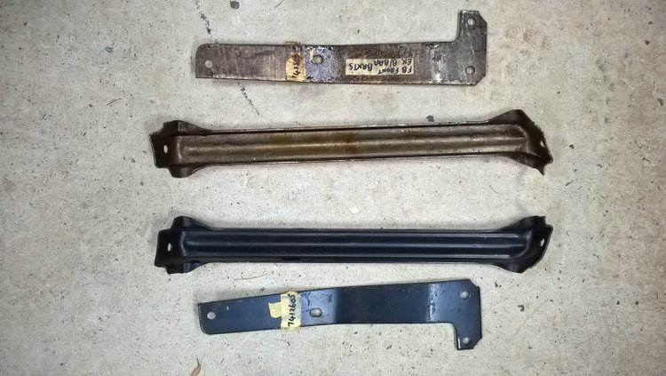

So I found my new old stock bumper irons and it has confused me even more now !!!
So one set are bare with rust preventing something on them and the other set is close to clinker grey so its anyones guess.
Now that throws a cat amongst the pigeons, although the unpainted one would explain why so many are rusted today.
I can't post the photo because its bigger than 2MB, does anyone know how to post a photo bigger than 2MB ?

I've shrunk the picture
So here is the two different NOS bumper bar brackets.
