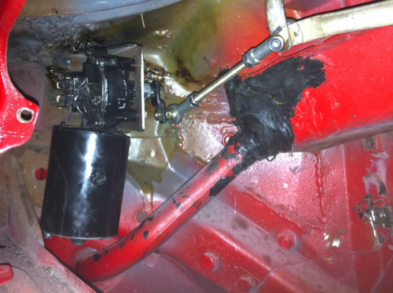

Hi guys, rewiring Helenor and fixing the wipers. My electrician says it has single speed motor, from research today all photos of single speed show 2 connectors, 2 speed photos show 3 connectors with some kind of electronic resistor/thingamy jig. This is the only photo i have, to me it would be 2 speed, but then again, i'm not an electrician.
engine bay mods 2.jpg (86.05 KiB) Viewed 20186 times
Bit hard to make out with all the black paint, but definitely 3 connectors.

Mate I'm going 2 speed.
For 2 reasons, one is the 3 terminal as you have said and the 2nd is because to have this car pass engineering in NSW it has to have 2 speed wipers.

That is a 2 speed wiper motor that I sent Scoob it will run 2 speeds with a Hr eh wiper switch
I have one in my FB wagon that I built I remember Scoob having trouble because there supposed to go in the engine bay not under the dash so probably had earth issues
On the wiper it has three pins labeled s1 s2 and bat s1 is for slow s2 is fast bat is for power
And on he switch if you use a hr Holden one its the two top pins are s1 and s2
I will pm you some pic of wiring / set up if you like :thumbsup:

You need to get the switch that comes from the same donor car I think Rob. If you don't know what car that is I would try HD HR or possibly EJ EH.
Although I have seen two position switches in some original EKs they never came out with a two speed wiper motor. It is possible the switch you have is from EJ HR if it has two positions. Note that three terminals on the switch does not necessarily prove that it is a two speed switch as it could also be for electric washer power via centre push button.
