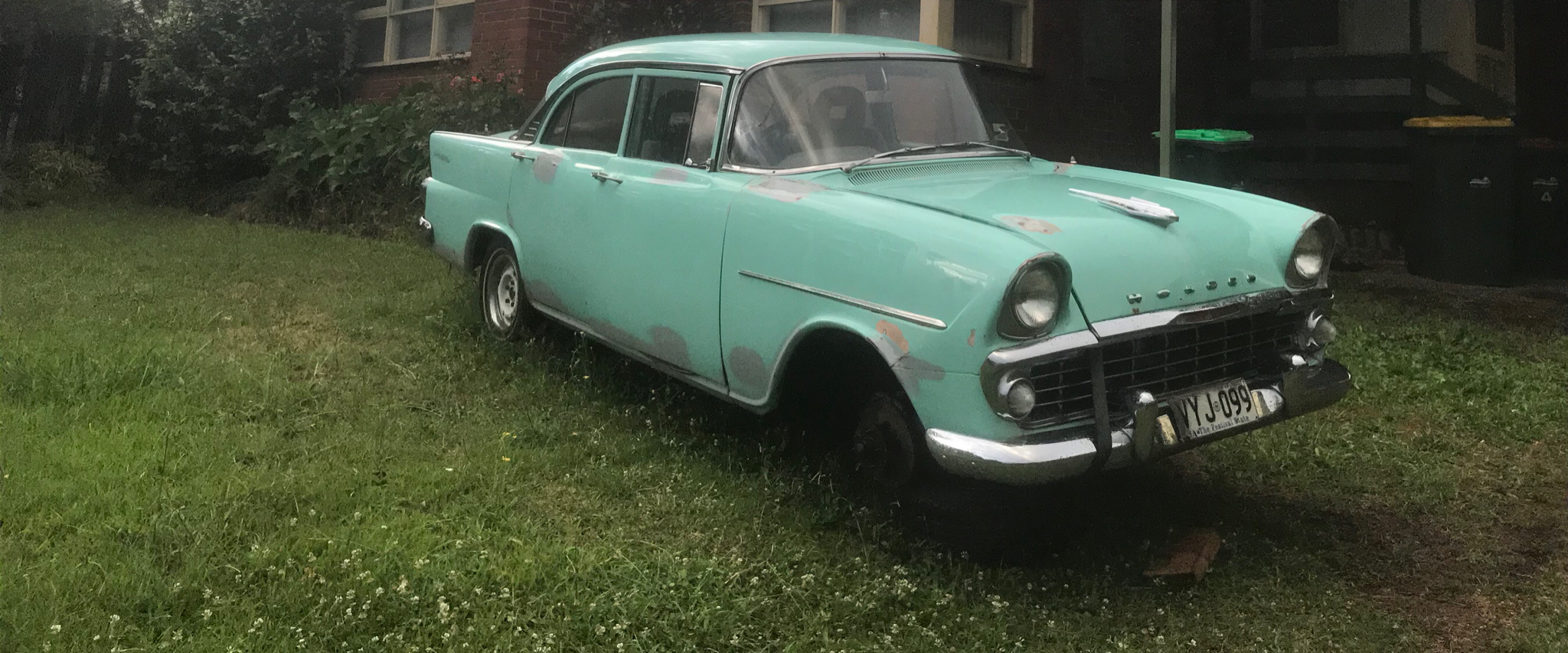

Colleen Green? My favourite. She’s had a bit of a dress up with the stainless window and gutter trim, chrome light surrounds front and rear. Obviously had some attention over the years.

Valetta Green (0250)
Yes, HR front end w/ torana brakes,186, trimatic and hr diff
I have some front surrounds if stripped to paint as standard, however, i am on the hunt for some standard rear lights.

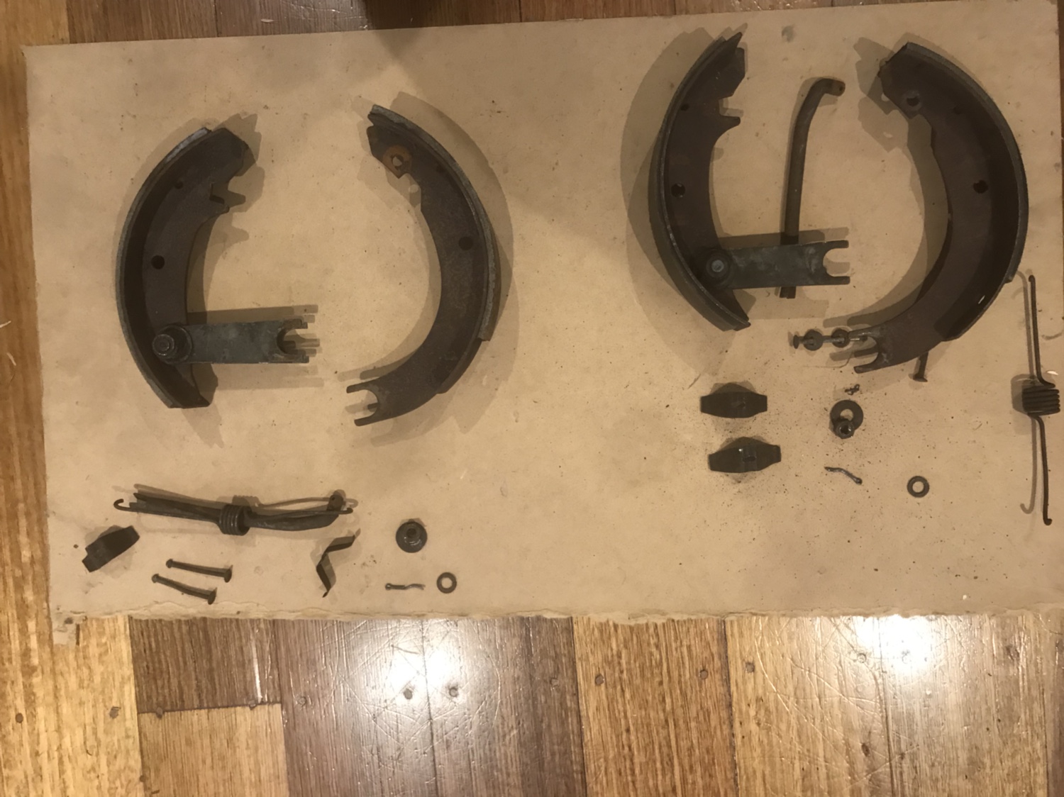

Unfortunately these are not HR Holden brakes...
Valerie the EK Standard Sedan
Posted: Tue Jan 09, 2018 7:24 pm
by gpi
EK brakes. Largest pads at the front...

You’re going to have to change the rear axle to match front brakes. What have you got in mind? EJ-H, HD-R, LC-J?

brake setup has hj proportioning valve and vh24 with PBR alloy LX-UC calipers and discs
