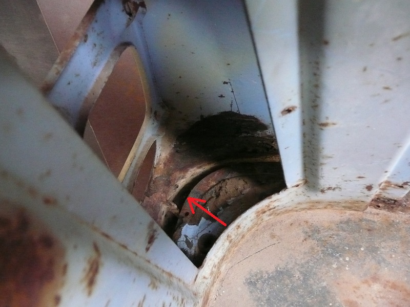

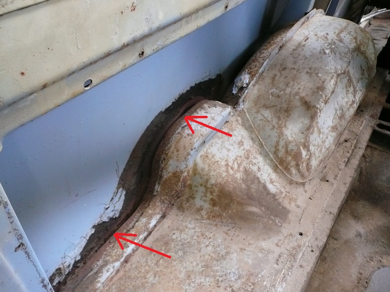

Anyone know if there's a replacement rubber available for the area indicated by the arrows?
Thanks, Phil.

theres a rubber in there ? I thought it was just seam sealer type goo ??
Re: Ute tub rubbers.
Posted: Thu Dec 28, 2017 10:45 am
Apart from wiring grommet and drain tube under the tail lights I thought so too

Blacky wrote: Thu Dec 28, 2017 10:31 am theres a rubber in there ? I thought it was just seam sealer type goo ??
Thanks for the replies guys!.....Its been so-long since I pulled whatever was in there out (22 years) I couldn't remember.

There is definitely a rubber under the sealer

You sparked my curiosity with this so I tried to cut out a section of the rubber extrusion used to fill the gap between inner floor and rear quarter skin from rear of wheel well right around to tailgate jamb by the looks.
Hopefully the photos show the shape. I had to cut through the two tails that were sandwiched between the panels. I reckon it would be possible to source something generic to do the job. Failing that a liberal application of butyl mastic should do the job. Won’t be seen once the covers are on. ImageImage

Thank you Clay!.....I thought there was a rubber in there somewhere!... I vaguely remember pulling it out all those years ago.

Definitely a rubber there mate I had a look at my Ute this morning and you can clearly see it from underneath I will post a couple of photos on Tuesday when I'm back in the office.
