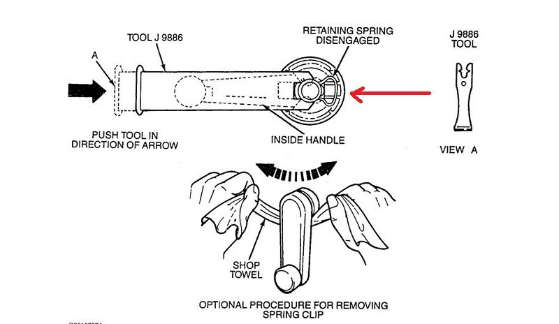

Have you installed the locking spring to the inside of the handle? Did you use a removal tool to remove the dodgy handles? The spring clips that hold the handle to the spline must be pushed all the way through for it to engage onto the spline. There is a spring behind the door trim that keeps tension on the handle so the locking spring stays in postion.

Sounds like the retaining circlips have lost their tension or are fitted the wrong way around.

This would be the first thing I try. New clips and push till they click and stay all the way on.
