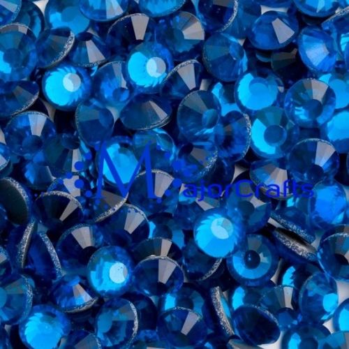

One drama I hit is that the ANDRA specs require the nitrous arming light to be blue, not red. I could remove the red "jewel" and poke the head of a blue LED through, but it would not look too neat. Any thoughts on how (and from what) I could make a transparent blue "jewel"?

Harv,
Ebay is your friend!........These are 5mm craft gems.
Re: Re-marking idiot gauge plastic
Posted: Wed Apr 06, 2016 10:46 am
Cool 8)
You just saved me a drama trying to machine something up.
Many thanks,

I cant get the link to upload, so here's the ebay item # 281991585701.

Got the gauges just about finished off. I ended up getting the plastic gauge lense engraved (with thanks Pete), and it came up pretty cool. I bought some "blue jewels", and added one for the nitrous warning light (yeah, I know... a bit of a poser for now :oops: . But one day :mrgreen: ). I gotta hide the spare blue jewels before the kids find them and Bedazzle the house. Made some cardboard dividers for the back, and got some LEDs/resistors from Jaycar.
