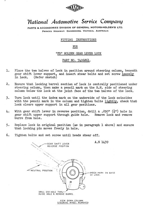

Does anyone have fitting instructions for the nasco steering locks?

Ok anyone got any pics of how it fits .... Trying to figure out where to drill the hole!
Don't want to stuff it up

Someone on here will have the instructions you need. Don't drill until you have them as it explains how to line everything up and how to use the guide hole to mark the drill point. Well at least it does for EJ/EH!

Theres a thread about these on the FE/FC forum , I have PM'd Alex for a copy as he says he has one.
Heres the link - http://fefcholden.org.au/forum/index.php?topic=19346.0

Here you go mate, they are small , hope you can zoom in enough to read them -
Thanks to customFC from the FE/FC forum for these 8)

Thanks Blacky that helps heaps

Hey Blacky - do you still have these instructions - they are not appearing anymore
7406861 Gear Lever Lock 1.jpg (80.98 KiB) Viewed 908 times

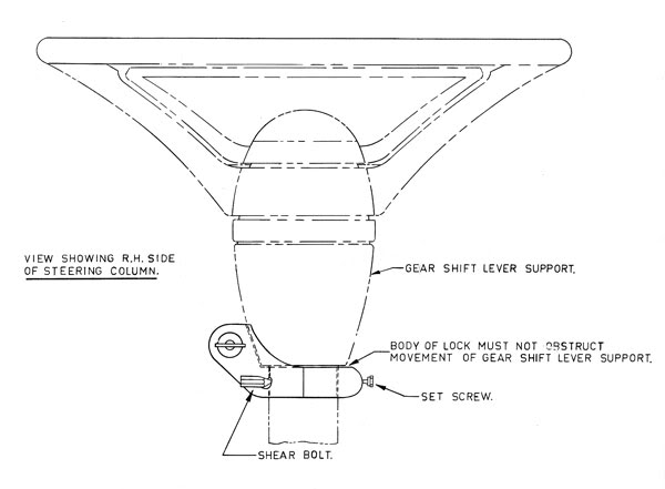

7406861 Gear Lever Lock 2 of 2.jpg (26.72 KiB) Viewed 908 times

by FJWALLY
Thanks Harv - much appreciated - think I'll have to load the back of the ute up with cartons for the nationals to repay some of these favours - cheers Lads
