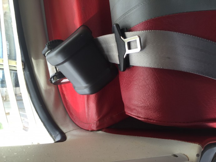

I mounted the reels on the rear divider panel between the cab and the tray - pulled the tray floor out and bolted them through right behind the edge of the seat and the B pillar. When we painted the ute I mounted plates in the pillars up top for the top bolt so I didn't need to remove the headliner to install them , just took me 5 years to put them in ....

Yeah I figured am happy with the inertia real on the parcel shelf as it can sit flat for proper operation but then the second point can only be on the floor right? Which will make it a pain in the butt to grab the belt each time you jump in which I had not properly considered before ordering.

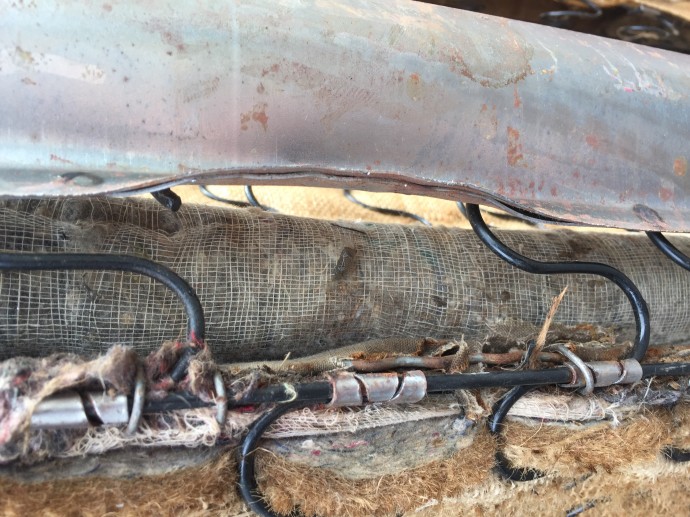

ok - all fitted without too much drama - some alterations to the seat as they are joined all along that back join - some chopping required of one wire each side to let the belts come through from the back - pics to come

Yes thats how I started Blacky but the clasp end is too fat to fit through and the two centre mounts need to be bolted in before you put the seat in for a ute as the length adjustment has to be done before you tighten the bolts - impossible to do once the seat is in.
It does not remove any real strength in the seat as where you cut has a reinforcing point - bend back the frame edge a little and it goes through ok but even then is a very tight fit.

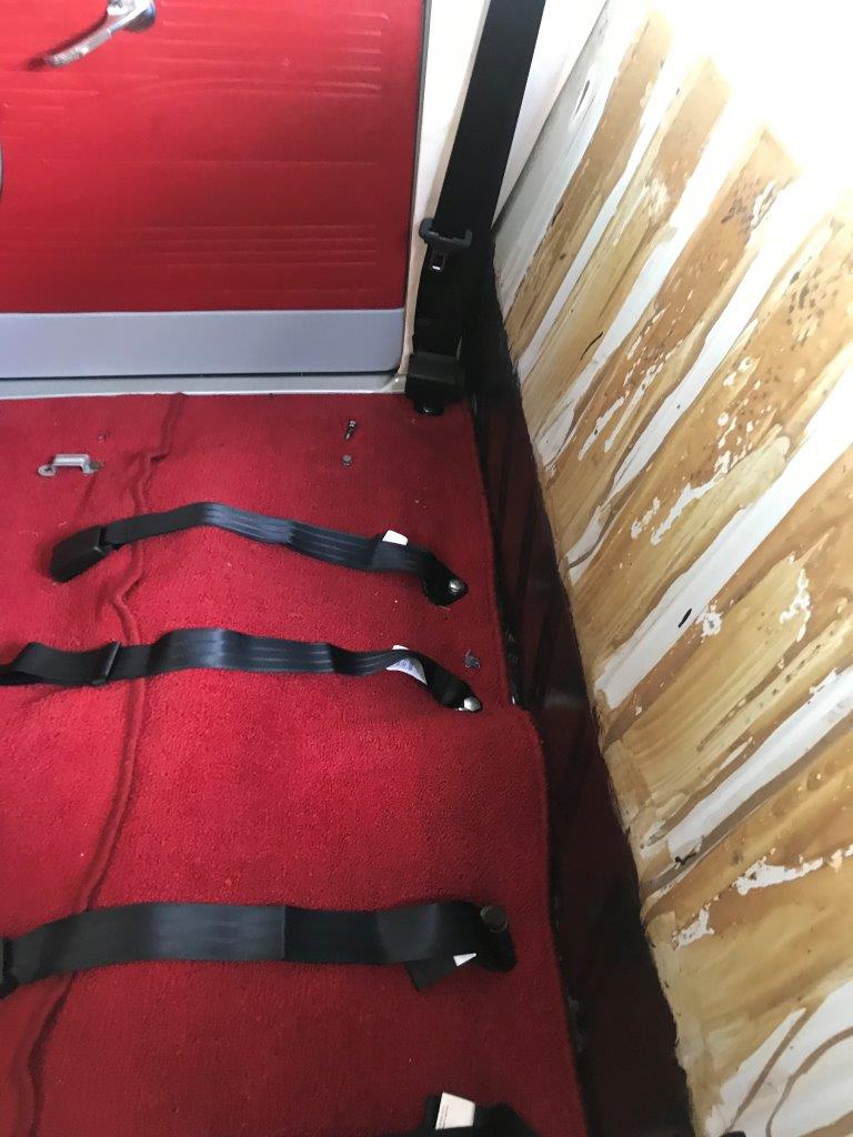

A couple pics of the install - you can see the wire piece I had to remove - was a simple job and where it is wont effect the integrity of the seat

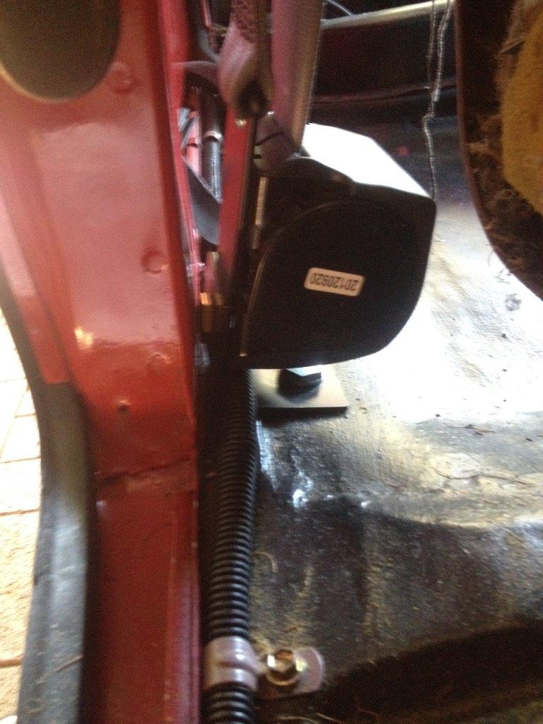

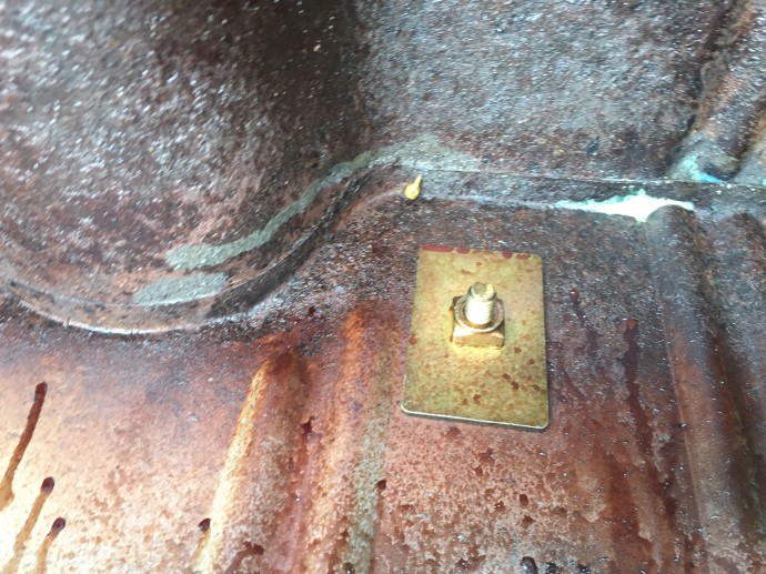

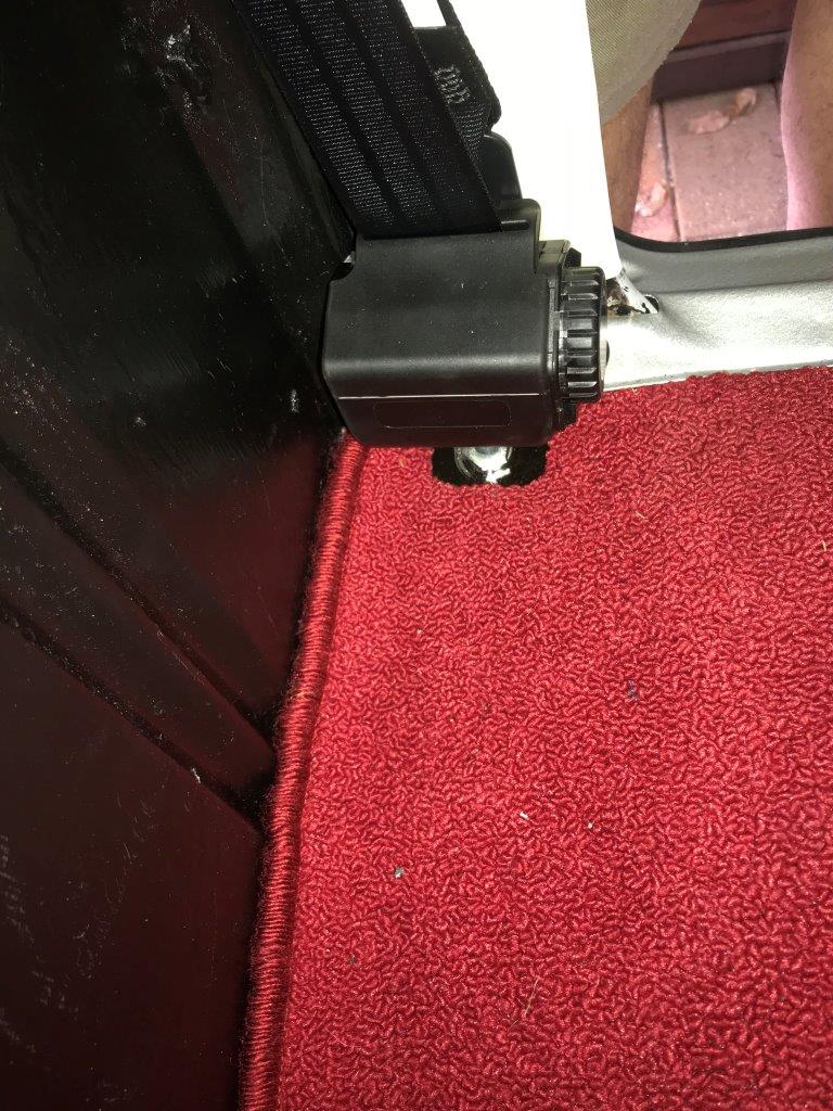

Errol62 wrote: Mon Oct 28, 2019 10:28 pm Where have people mounted lower fixings? Not sure about mounting through the cargo barrier as this is only spot welded to floor.Inertia reel mounted to cargo wall seems ok as the load is shared with the b-pillar. Will this clear seat bottom when back as far as it will go?

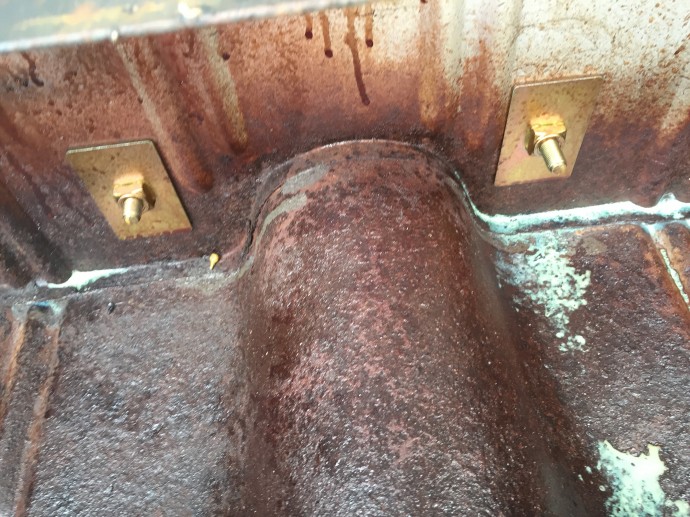

I mounted Grace's inertia reels at the base of the B-pillar. Hemco make a 90º bracket that allows the bolt to pass vertically through the floor pan, using a 6"x4", cad-plated, captive nut reinforcing plate that they also supply. Seat still slides fully fore and aft. Sometimes the floor pan is not horizontal (like in the last photo below) and the bracket needs some creative bending (with a BFH) to get the reel to sit hard up against the B-pillar.
The photos below show the installation in Grace's ute. The last photo is a similar installation in my wagon, which shows the bracket better (before it was adjusted in a vice with the BFH):

I can't get pics to you for a couple days but will later in the week - I had the top mount reinforced into the B Pillar and Bottom also on side - I put side belts through the tub wall rather than the floor with the added load spreader plate which is fine by all reports - my tub was in great condition with next to no rust so I was confident it was sound and we add a few welds to strengthen when we had it stripped back.
