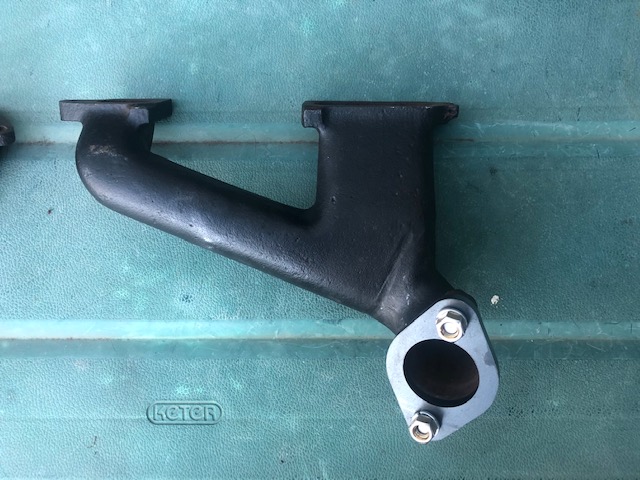

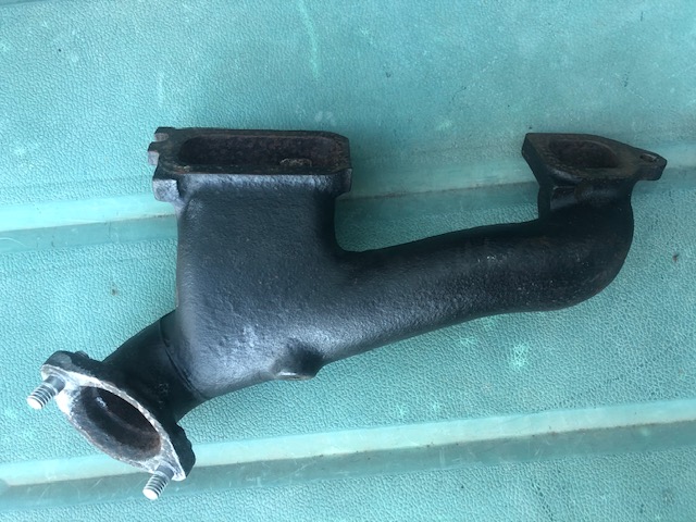

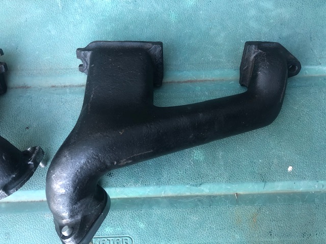

Posted: Fri Jun 19, 2020 3:59 pm
Errol62 wrote: Fri Jun 19, 2020 3:18 pm Harv, the GTR rear flange is more inclined to vertical than Holden. Front is same part except HD which has no boss for the tube.
Not sure if these help identify or not:

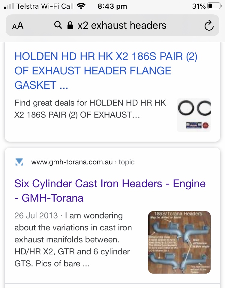

Re: GTR Header
Posted: Fri Jun 19, 2020 8:48 pm
by Fex
Quick google search “x2 exhaust headers” revealed this if it helps.. scroll down a bit from the top.. There is a heap of explanatory text in that forum as well
Cheers, Andrew

Re: GTR Header
Posted: Sat Jun 20, 2020 7:02 am
Many thanks - that is useful. Summarising the info from that site:
There are three versions of the front header:
1. no casting for the auto choke pipe,
2. casting for the auto choke pipe but not drilled, and
3. casting for the auto choke and drilled to accommodate riser pipe.
All three versions of the front section will 'fit' either the X2 or the LC GTR, XU-1s or 186s. The plain (no casting) was originally fitted to the X2 but the drilled auto choke version is needed for the LC GTR and 186s. Typically LC GTRs, LC XU-1s and LJ XU-1s are fitted with front version type 3.
There are two versions of the rear header:
1. the flange points more downward,
2. the flange is longer and points more rearward.
Version one was used on the HD 179 X2, which had two separate engine pipes all the way to the front muffler (all of the others had a Y-pipe which will not fit up to the HD headers). The HR X2, GTRs, XU1s and 186S used version 2.
I've got front header version 1, and rear header version 2. Suits everything except a HD 179 X2, and suits a WW Strommie.
I'll call them HR X2 headers, but if any of the Torana boys ask, they are LJ XU-1 headers :lol:
