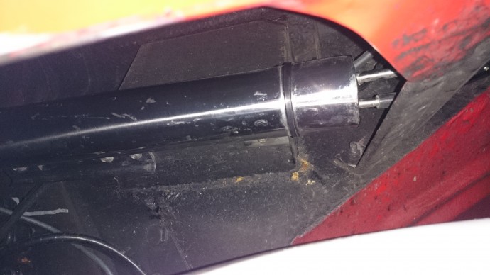

Washer bottle, no, stainless tube under the LHF guard, holds 2 med. take away coffee cups of water, can fill it with wheels turned full lock to the left, but much easier with the car jacked up. That taken care of, turn wipers on, no flow, water leaking out of the washer pump, get new washer pump. Also mounted to the LHF inner gaurd, with a stainless hexagon head bolt, like everything else, everything is mounted using stainless allen head bolts, great quality. With the new pump now on, and jets removed and cleaned, try again, mmmmm, large amount of water cascading on to my feet. Dash out to find the hose hanging freely with the brass tube from the D collar fallen/forced out of it's hole. Remove the D collar, insert brass tube back in the hole with some glue, put it back together, wish it was that simple what with the windscreen trim pushing the D collar out of alignment, never worked on one before, made it a much longer job than should have. The hose was attached to the tube with the help of a cable tie because the hose is too big for the tube, so wrapped the tube with a small amount of tape, seems to work ok, good enough to get through a roadworthy anyway.

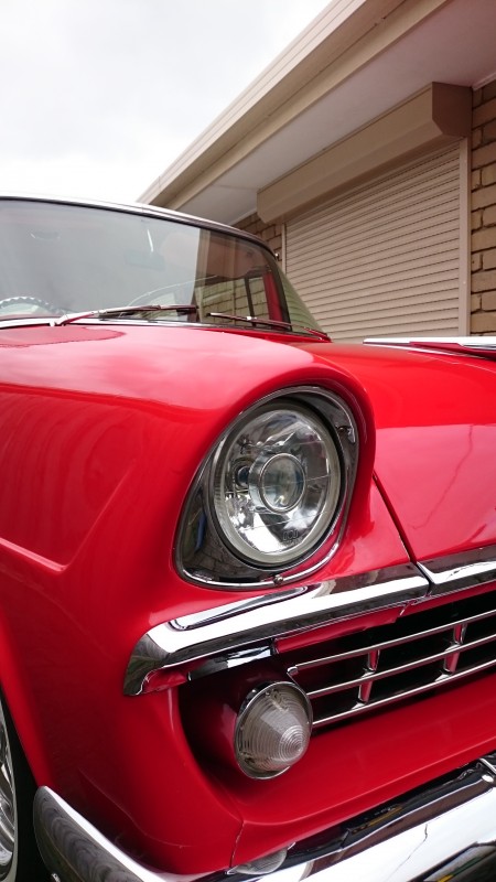

Yeah. Black, even the H4 on the glass is on a slight angle, will try another type or something from a wreckersBlacky wrote:Is a great looking car , what Rosco said with the stainless bolts - they gall up real quick if they haven't been coated with Nevr-Seez or something. he headlights seem to sit right in the buckets going by the photo above, that's weird ...

New headlights to replace the ascew semi sealed units in it. So called Projectors with 55/60 white Halogens, see how good they are tonight. Guess that's that till next Tuesday, hopefully have some pics with Vic plates aboard.

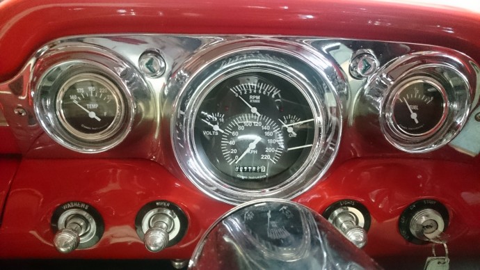

The instrument cluster had no ignition lights, just an orange light in the ash tray compartment, & the high beam indicator was a RED LED, not satisfactory, so i ordered 2 red 4mm LED lights from Newark Element 14[attachment=3]Red LED.jpg Gauge works here in Geelong can unroll the chrome surround & fitted the LED's just above the volt & oil pressure gauges. While apart they replaced the high beam indicator with a blue diode, so it all looks a little bit standard.

I'm not a great fan of modern gauge replacements, but this one certainly ticks many of the boxes when it comes to keeping auxiliary gauges within the confines of the binacle. My only concern is the oil pressure gauge - I probably would have gone for one with a lower value scale - along with the tacho. I do appreciate, however - that manufacturers are limited to what they can realistically make viable, and the values available are dictated by demand.
As for your work with fitting LED's for your oil, alternator and high beam - great work.
I'm not sure why you included the pic of the red LED in a holder - perhaps this is what you used within the main gauge.
If so, there is a much smaller option - that being a simple one piece insertion holder with barbs and a locking ring which fits over it once installed. This tiny fitting allows just two ultra-fne leads to exit the back of the gauge.

When I fitted LED's to my gauges, I employed the "jewel" lenses in the idiot light cluster. By carefully drilling out the centres of them from behind and without breaking through the face, I was able to file down LED's to an interference fit and insert them in the jewels.
I do appreciate that this would have been overkill in your application and would have resulted in the high beam LED looking out of place when employing the original jewels in the oil and gen lights.
One final suggestion I might have made (which you may still be able to include) is the fitting of an additional red LED to the cluster as your alarm warning light...
I almost detest the drilling of holes in the aluminium dash trim - I did this to mine back in the '70's and hated it. I have replaced that trim and take pride in the discipline of not weakened to drill any of it again.
